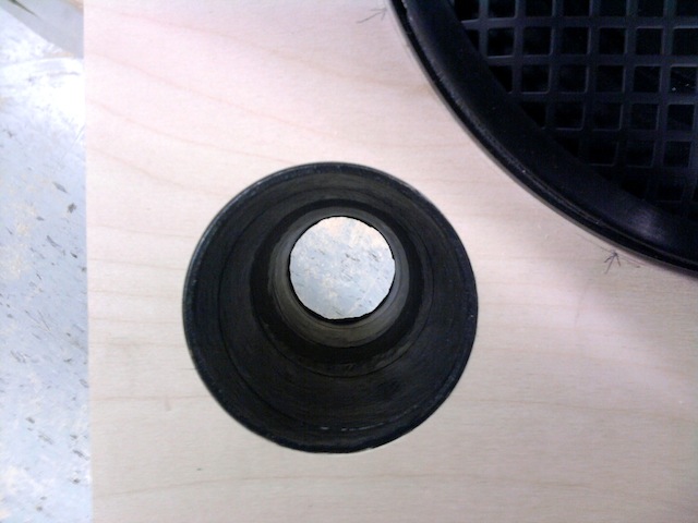

As a guy with little experience with a router, I am proud to say I made the port cutout the correct size to accept a snug press-fit of the tube, flush with the front of the baffle. I ran a bead of Gorilla Glue around it on the inside.

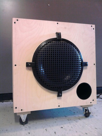

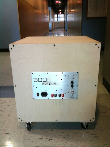

Re: skywave's 3Pi subwoofer build [message #75102 is a reply to message #75039] Mon, 31 December 2012 17:14 Go to previous messageGo to next message
Messages: 107
Happy New Year to all!
Here's a few pics of the 3Pi Sub. We will be applying truck bed liner paint later in the week. I'll post the results, good or bad.
index.php?t=getfile&id=957&private=0
index.php?t=getfile&id=958&private=0
index.php?t=getfile&id=959&private=0
index.php?t=getfile&id=960&private=0

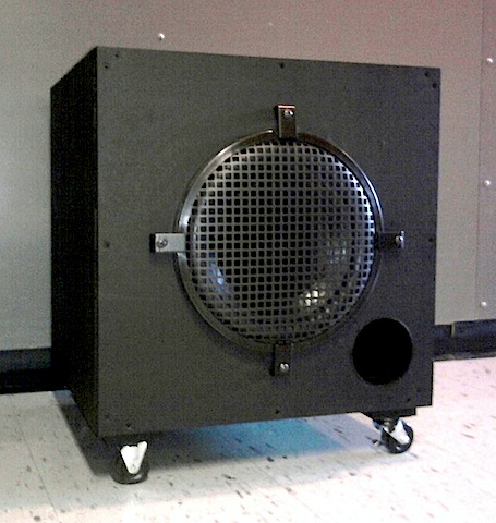

Re: skywave's 3Pi subwoofer build [message #75413 is a reply to message #75124] Fri, 01 February 2013 14:04 Go to previous messageGo to next message
Messages: 107
OK, here's the truck bed liner version in grotesque industrial dreadnaught black. In the future I would try something else. The fumes are amazing for glue sniff-heads, and the blotchy-ness was not consistent as to look intentional. LOL.
But it's done. And works great!
The students get to do all the dirty work:
index.php?t=getfile&id=1003&private=0
index.php?t=getfile&id=1004&private=0
