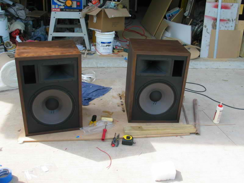

About six months ago i decided i wanted a change of pace from my OB speakers. I had numerous audiophile friends that had jumped on the CD bandwagon that had purchased Abby's and were touting their benefits.
I liked the looks of Wayne's Pi4 offering utilizing the 15" mid bass woofer. So i decided i wanted to take the design as far as i could utilizing premium components. I built the cabinets with 1" mdf and purchased Jantzen SuperiorZ caps, Mills resistors and Erse inductors and good copper binding posts. I had to use some Dayton caps i had on hand to complete the circuit.
I really liked the results but didn't have the level of resolution that i was used to. As i slowly upgraded the remaining lower quality caps the resolution increased and then installed a couple of teflon bypass caps in each circuit, now i had the resolution i was hopeful of.
I know most of the builds are for HT use and standard components are adequate but the design is worthy of high end parts if your looking for audiophile results.

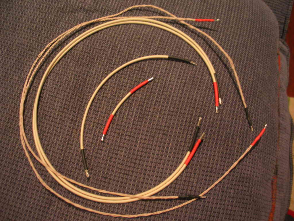

Just recently i did another upgrade of which i was hardly prepared for the overwhelming results. I upgraded the internal wiring to the drivers and binding posts. I know the benefits of using good wiring and have experienced positive results with interconnects and speaker cables. (Not looking for any cable debate but to share my experience).
I thought i had used a decent hookup wire when i put the speakers together, solid core 16awg high purity copper wire. A buddy of mine that owns and makes high quality cables (Wywire) sent me a speaker wire harness that he makes for several high end speaker manufacturers.
It consisted of high quality Litz copper wire for the tweeter circuit and thicker litz wire for the bass driver.
index.php?t=getfile&id=916&private=0
I got both speakers done and i cant believe all the performance that has been left on the table until now. The upgrade was akin to a new higher quality amplifier. Sound stage has increased,bass is deeper and tighter and the highs are detailed but smoother. I did one speaker first and compared the two, I had to unhook the undone speaker, it was as if it was shouting at me. It now sounded sibilant and distorted by comparison. Now that both speakers are done i am in heaven. The resolution and micro details are off the charts. The Pi4 is truely an audiophile speaker when fully utilized. The harness cost just over $100 but has to be the greatest result for the money i have ever experienced. I have fairly high end electronics and your results may vary but highly recommended.
So i feel like i have reached the end of my journey and now i can sit back and enjoy the fruits of my labors.
