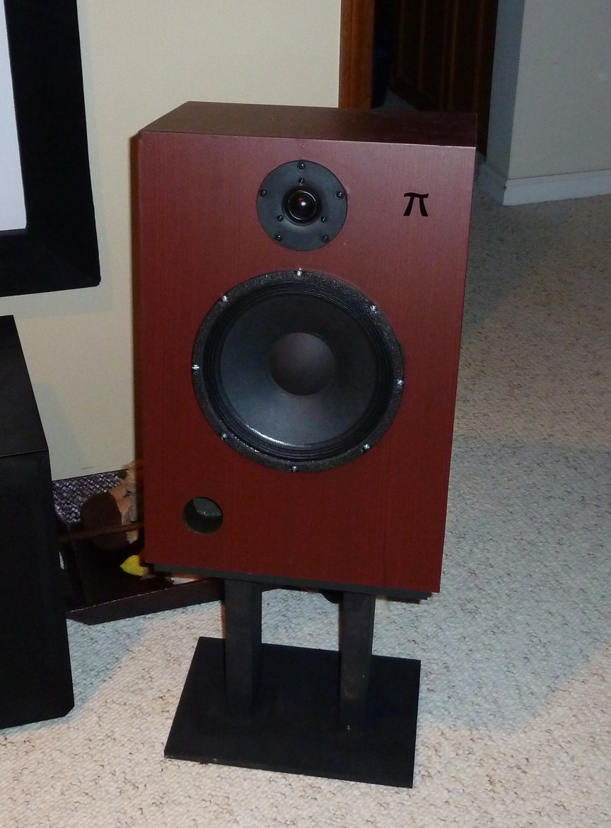

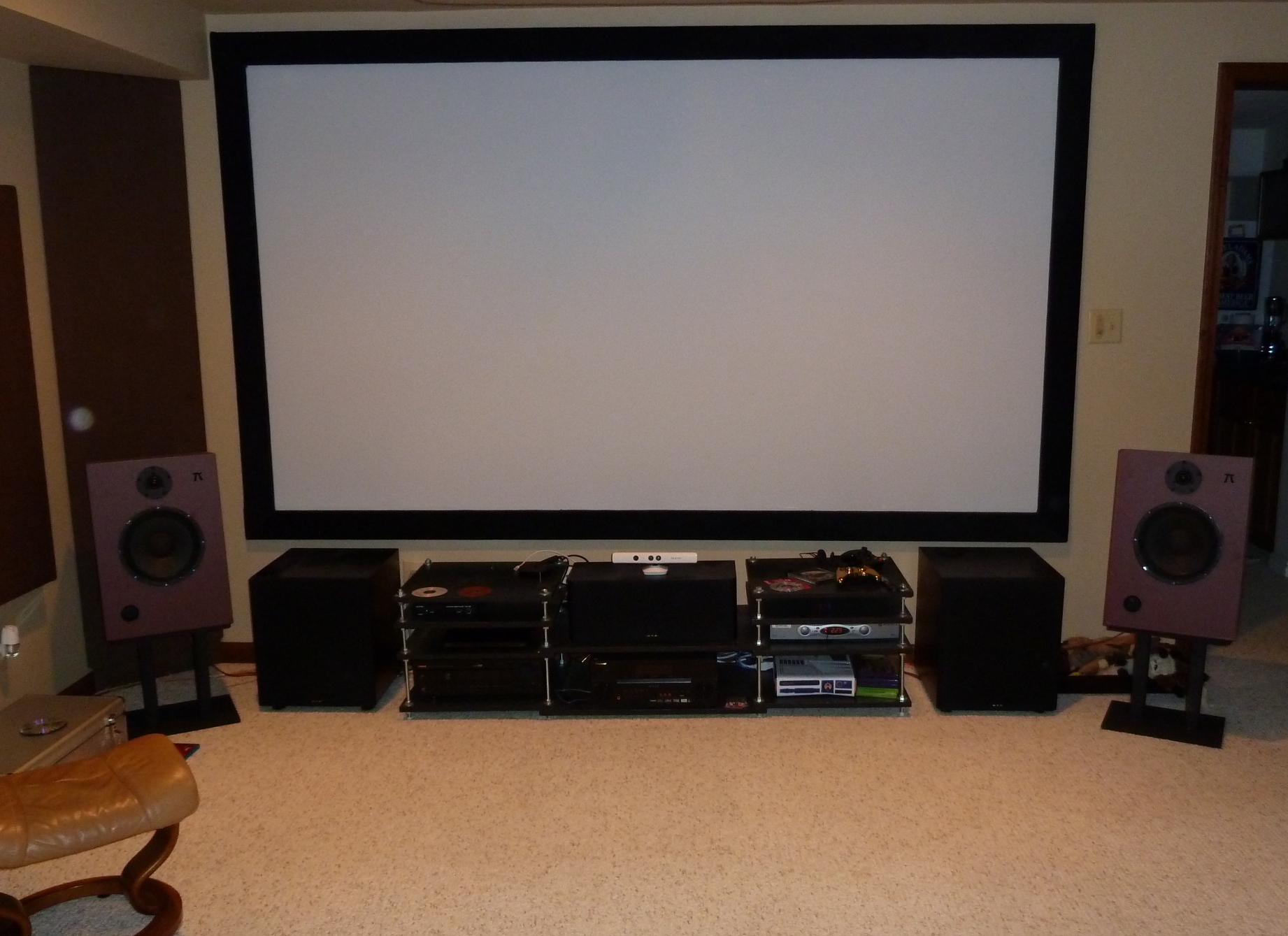

Here is my first build, a pair of 2Pi speakers. I love the sound, but plan on rebuilding them as towers and focusing on a bit more pleasing woodworking. I have good skills in woodworking, but not so much in electronics and crossovers, etc. I have read most everything on this board, but still am not sure how to proceed in adding a center channel.
index.php?t=getfile&id=912&private=0
index.php?t=getfile&id=913&private=0
I need some help with center speaker idea that I read about on this forum by boblaz, over 10 years ago in this thread. http://audioroundtable.com/forum/index.php?t=msg&goto=38376&&srch=1pi+build#msg_38376
He mentions using a modified 1 Pi with good results, would the 1 Pi work with the 2 Pi's in my room. My thinking is a double 1 pi with a single tweeter in the center. Is this a stupid idea.
My other thought is an additional 2 Pi speaker, but since our screen is so large it would come to just about the bottom of the screen. The benefit of an additional 2 Pi, is the cabinet is already made.
My current set-up has the two subwoofers wired with a y connector off of the subwoofer channel. I have tried to wire has flanking but not sure I did it correctly. Do I just run two set's of wire from the left/right channel to each subwoofer and 2 Pi? My receiver is a Pioneer Elite VSX-01-TXH.
The main uses for the room is movies and some TV, and some music listening if we are playing pool in the other half of the room.
To summarize, I love the 2 Pi's and now need a center that can keep up.
1. I plan on building 2 Pi towers, so can I please have plans for towers Wayne?
2. Would a modified 1 Pi center be to disrespectful to Wayne's hard work? Would it sound good? Surely a lot better than what I have now, that most people think is great. If so I will order a kit for a single 1 Pi and will of course need plans.
3. What is best way to wire flanking subs from one home theater receiver?
4. Does the 4 Pi idea of phantom center channels apply at all to the 2 Pi's?

Those are great looking speakers, congratulations!
You can use a one Pi as a center where you have one π, two π or two π towers as left/right mains. There is enough spectral match between the three. However, do not lay it on its side or use any sort of horizontal array (drivers side-by-side).

Ideally you want the same speakers for R C L ... But a Tower 2Pi won't fit under the screen.
Next best would be to use the same drivers. 2Pi Towers on the sides and a regular 2Pi as center.
And it looks like it'll juuuuuuuust fit!

That makes the most sense to have all three the same as much as possible. It will just fit, I wonder if the size of the 2 Pi can be shortened a bit and expanded in depth or width, mainly to allow a slight angle to the speaker towards the listener it this is recommended.
In reality most movies we watch are shot wider than 16:9, which is why the screen is so big, I may willing to make the screen smaller in order to get better sound quality.

Here is the current plan, build 2 Pi Towers for left and right. Reuse one of the current cabinets for the center channel. Shrink the screen size slightly, and make the screen frame 3" instead of 4". This will allow for a better looking soundstage. I will run the subs as flanking with 100 Hz active crossover.
It may be necessary to remove the corner mineral wool for the best sound from the left speaker, this will require testing.
As for the doorway that is actually a 100" opening to the kitchen area in the basement, so the speaker on that side does not really interfere with the doorway.
Next year, I will build two 3 Pi subwoofers for the front and move the two that I have to the rear of the room.
