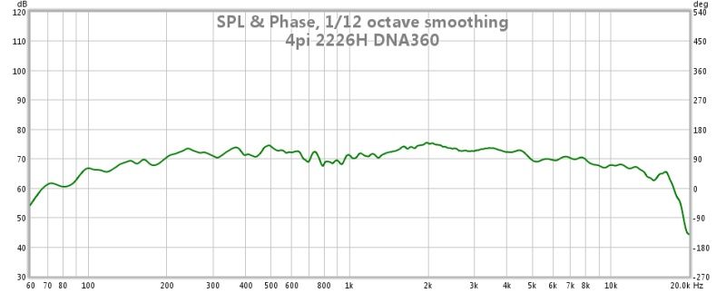

zheka wrote on Sat, 03 November 2012 15:26
I finally had a chance to open the speaker with unhealthy boost in the crossover region - the zobel was disconnected! what a relief.
I thought that was probably the cause. Glad you took the time to measure the speakers - It sure helped you nail it down!

Tonight is the first time I am using your speakers in any meaningful way. I cannot be happier about what I am hearing.
Thank you very much.
