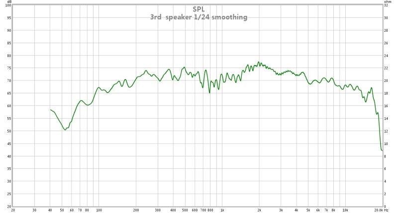

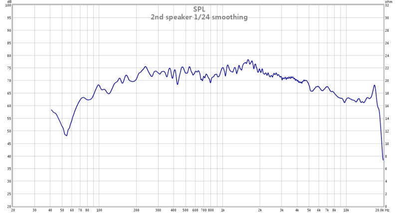

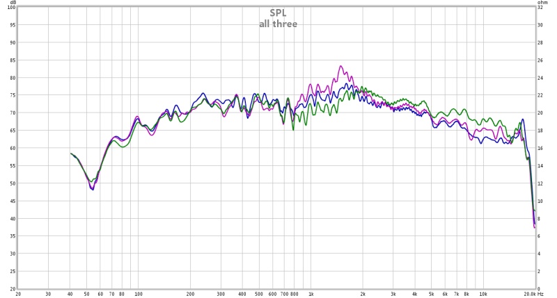

Hi Wayne,
I finally assembled the speakers and took some rough measurments.
Can you tell me if the graphs look sane?
index.php?t=getfile&id=893&private=0
index.php?t=getfile&id=894&private=0
index.php?t=getfile&id=895&private=0
index.php?t=getfile&id=896&private=0
index.php?t=getfile&id=898&private=0

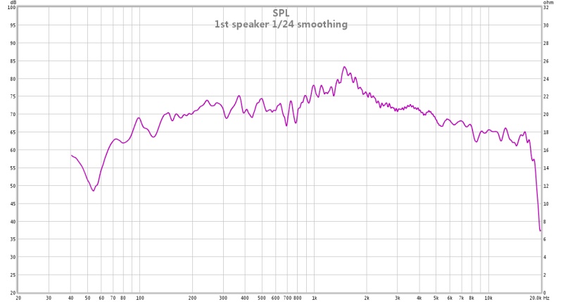

I am especially concerned with the 1st speaker. what do you think about that bump in the crossover region ?
thank you very much
Re: 4Pi measurements [message #74240 is a reply to message #74239] Wed, 24 October 2012 00:33 Go to previous messageGo to next message
Your measurements look right except for two things:
1. The first speaker does have more peaking around 1.6kHz than it should. Could be the crossover, or it could be the midwoofer cone. Is it a new woofer? If not, you might measure it by itself and see if there is excessive cone breakup. Also, check your crossover and make sure you have the Zobel connected. A missing Zobel will do that. And check all the other values too, especially the capacitors in the woofer circuit and the coil in the tweeter circuit.
2. There is more rolloff up high than I would expect. They don't falloff this much in the top decade. I'm guessing it's something in the measurement system. It has what appears to be a first-order rolloff above about 2kHz. I don't really think your speakers are doing that, partly because it is consistent across multiple speakers, and partly because this is a fairly common measurement problem. I see it happen pretty often, people produce a curve that looks a lot like mass rolloff even on speakers that couldn't possibly produce that kind of response.
Other than those two things, your measurements look right. I think if you were to conjugate that abnormal first-order filter above 2kHz, your response curves would be exactly right.
You've done a very good job, and I'll bet they sound great.

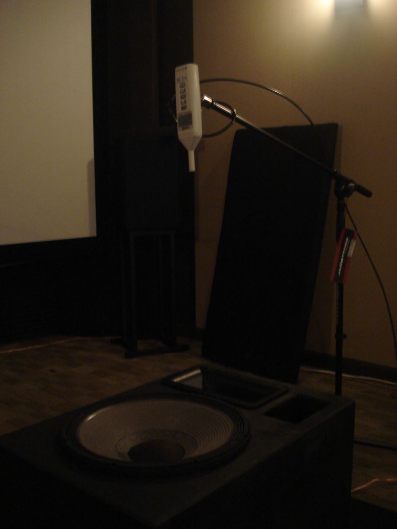

1. it is a second-hand woofer. I will check the Zobel connection. But if I need to, how do I go about measuring the woofer by itself? Do I remove it from the cabinet and feed the signal directly, bypassing the crossover? or should I keep it in and simply disconnect the compression driver? or keep it in but bypass the crossover? Also, what frequency range should the test signal cover? Is 40Hz-2kHz range reasonable?
2. re: HF roll off. What are the common measurement pitfalls that can account for this? I am thinking that positioning of the mike may be the issue. I tried to point it at the edge of the woofer or slightly above, between the woofer and the horn. If I remember correctly, that's where the center of the front lobe is supposed to be. But given that the measurements are fairly near field, should not the mike be pointed straight at or at least much closer to the center of the horn?

To measure the woofer, leave it in the box and just disconnect the tweeter. A sweep up to 2kHz or 2.5kHz is sufficient, but it wouldn't hurt to go to 4kHz. I would measure it two ways: (1) Measure the woofer connected directly to the amplifier (without crossover). This will tell you what the woofer is doing, all by itself. If it has excessive breakup, this will show it. Then (2) measure with the woofer crossover connected, which should show smooth rolloff above 1kHz. If it peaks at 1.6kHz, we have a problem with the Zobel or the core low-pass splitter filter.
As for the HF, you have the microphone positioned exactly right. In fact, it will be pretty much the same even if the microphone is moved towards the top or the bottom of the box, until you reach the point of the vertical nulls, which are pretty far apart. See the following thread, and click on the "Vertical Nulls" link for a video of the measurement process (just like what you're doing):

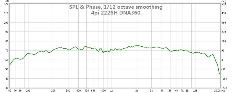

I finally had a chance to open the speaker with unhealthy boost in the crossover region - the zobel was disconnected! What a relief.
This is my response curve now:
index.php?t=getfile&id=1254&private=0
