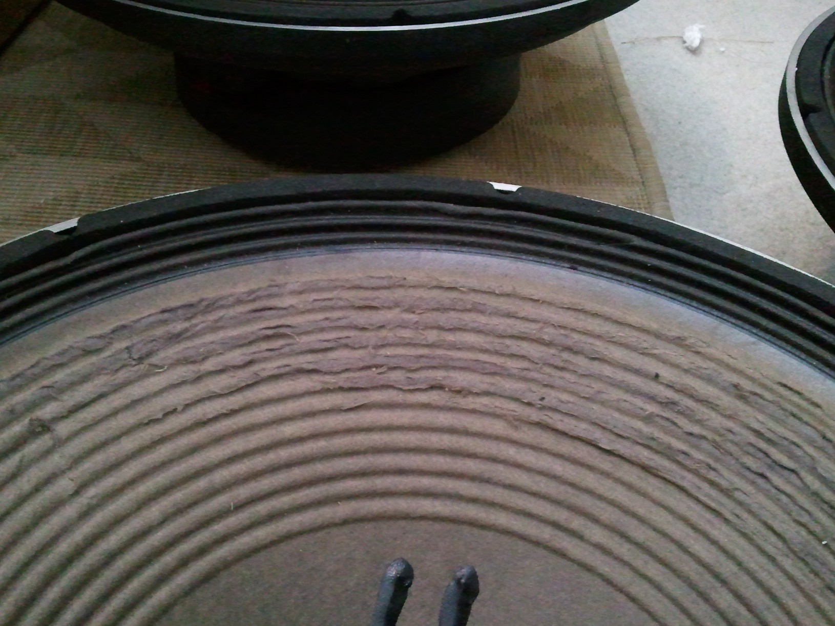

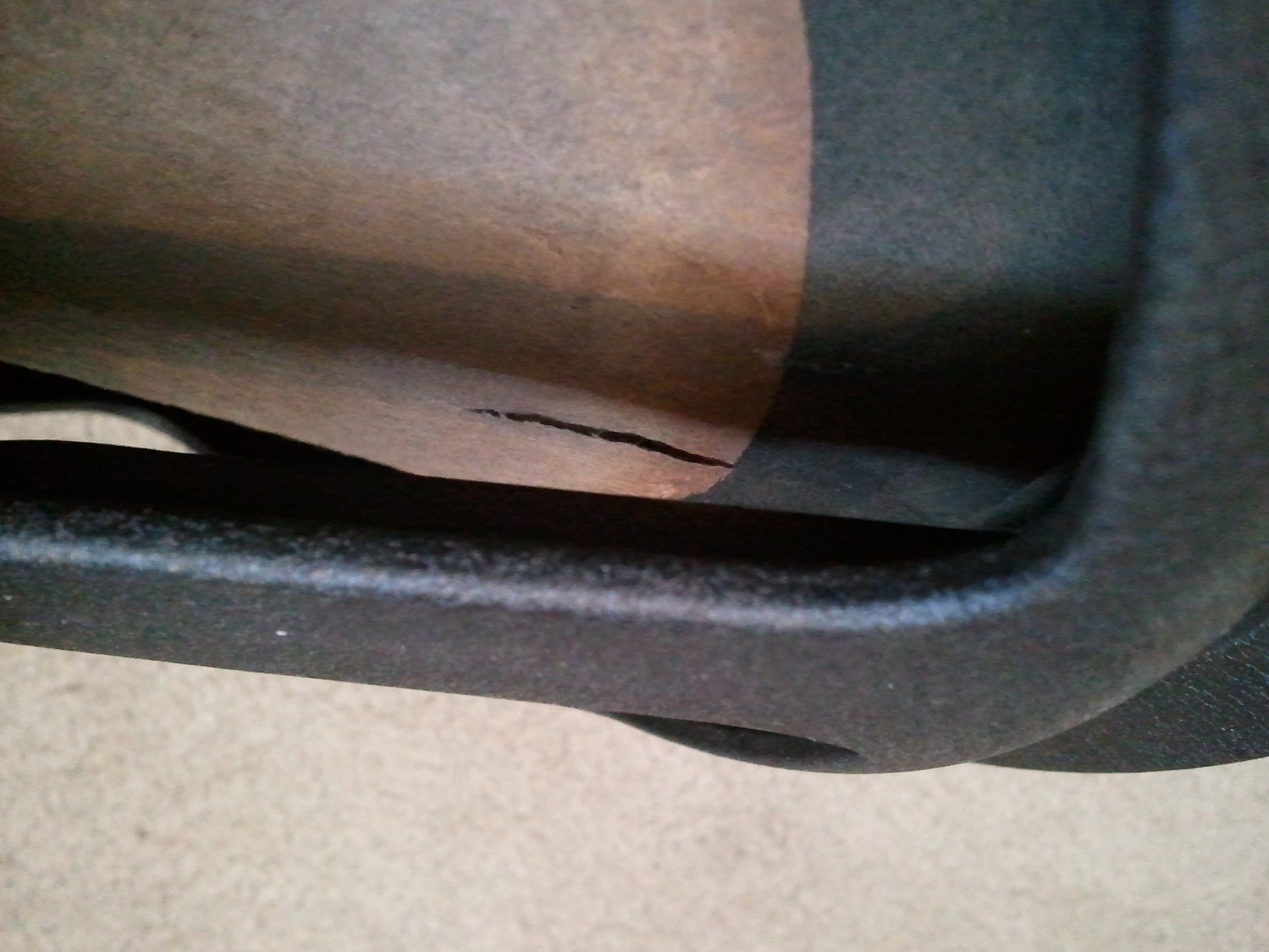

Hi all. I just got some 2226H's in the mail and it appears one of them got damaged during shipping. Is there any way to repair this without buying a recone kit ($70-$100)? I'm not worried so much about the crack since I can fix that with some watered down glue, but I am worried about the chafing on the cone itself. The cone also sits a fair amount below neutral in its range, which worries me as well.

That needs a complete recone. You can jury-rig a patch on a table radio speaker with white glue, but you don't want to do that on a high-fidelity speaker like this. It's a waste of material. And the spider is shot too. No amount of "break-in" will fix a sagging spider - it has stretched.
Get a full recone, and make sure it is done by a good technician using genuine JBL parts. If you don't know a place that you're sure you can trust, send it here:
