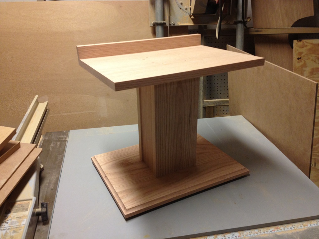

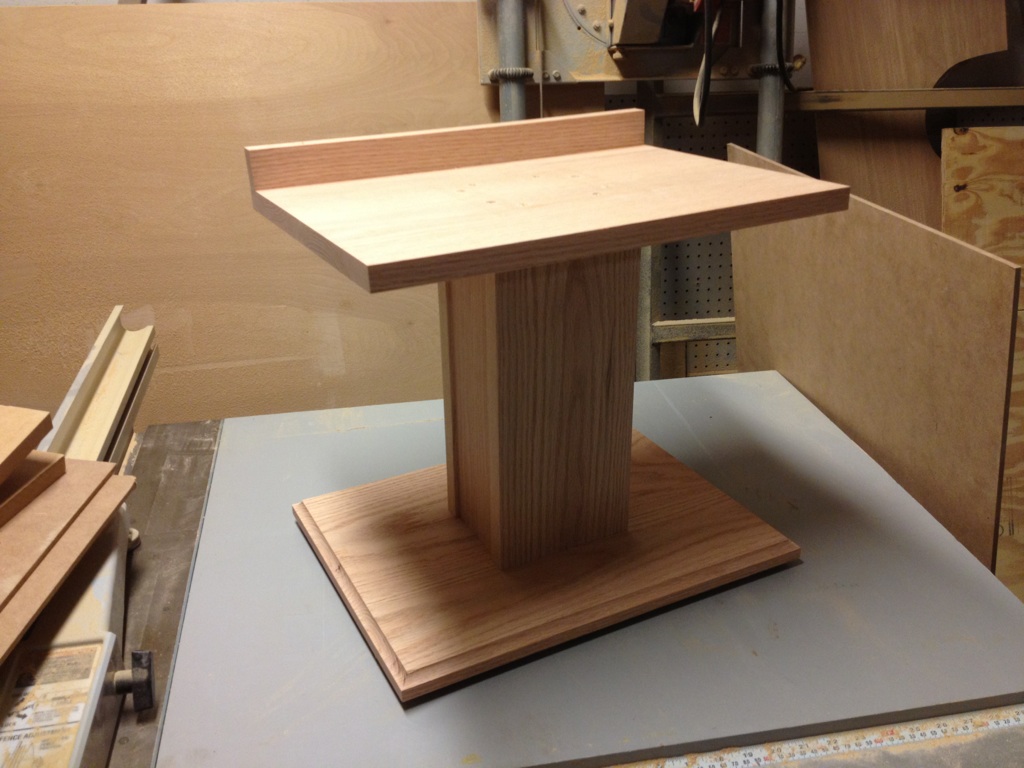

index.php?t=getfile&id=836&private=0Here are the stands for the speakers (made from solid white oak). I liked Wayne's stands so I just copied the design.
  • Attachment: IMG_0137.jpg
    (Size: 186.13KB, Downloaded 5469 times)

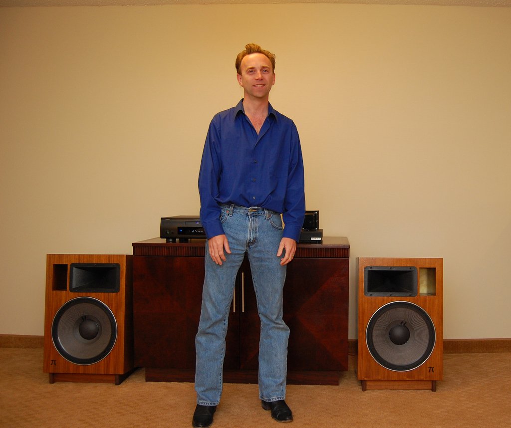

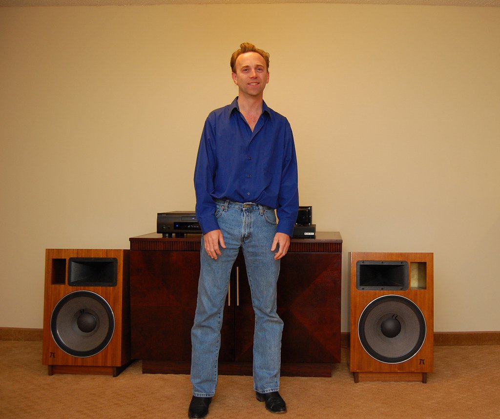

Wayne,
I know that you can't paint the insulation but I do not like how the insulation shows in the ports of the 4pi's (right speaker in the picture attached). My question is could I buy grill cloth (http://www.parts-express.com/pe/showdetl.cfm?Partnumber=260-335) and just attach it to the back the air port before I install the insulation?
index.php?t=getfile&id=837&private=0
Re: A month away [message #73607 is a reply to message #73605] Fri, 17 August 2012 17:16 Go to previous messageGo to next message
Messages: 241
Hi fellow Chicagoans,
Don't cover the port. You may get screwed up response. Just shoot a bit (not a lot) of flat black paint into the port instead.
Steve
Re: A month away [message #73609 is a reply to message #73607] Fri, 17 August 2012 19:20 Go to previous messageGo to previous message
Agreed. I've done that on some speakers with dark wood, where the contrast was really stark. On those four π's in the photo, the color of the insulation looks pretty good to me, but I think the flash from the camera lit it up just right to make the contrast seem more striking. In normal lighting, the port is deep enough no direct light reaches the insulation so it appears much darker.
