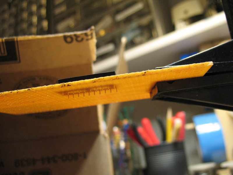

I would definitely socket the chips. Don't get the cheap little tin jobs either, get good gold plated sockets. You're right, they're designed to mount on a printed circuit board. Put it on a perfboard, and solder to the side with pads.
Re: IR Remote Control [message #72964 is a reply to message #72930] Sun, 10 June 2012 06:36 Go to previous messageGo to next message
Got the Digikey package and I'm suspiciously eyeing the little bit of post that extends thru the perfboard!
index.php?t=getfile&id=793&private=0
Gonna be tough to lasso those with solder, pardner.

Bill, maybe you could use those IC perfboards that RS sells, or similar, which have solder traces and through holes. I am going to try to use those for the chips.
http://www.radioshack.com/product/index.jsp?productId=2102845
http://www.radioshack.com/product/index.jsp?productId=2103799
