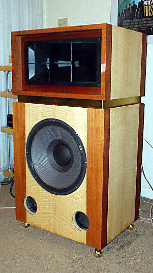

Re: Will 2Pi Tower 12x46x18 change the response appreciably? [message #72577 is a reply to message #72485] Sun, 06 May 2012 14:19 Go to previous messageGo to next message
Great minds!
I have a design on paper right now with 2" of hardwood framing the MDF portion of the baffle. That makes the 12" veneer work and allows easy round-over of the corners.
Only problem is I'm less than enthused about framing this veneer, even with solid gold. It's that breath-taking!
This framed design worked out pretty well, though; anyone remember this:
index.php?t=getfile&id=770&private=0
  • Attachment: Model 19.jpg
    (Size: 84.96KB, Downloaded 3286 times)
