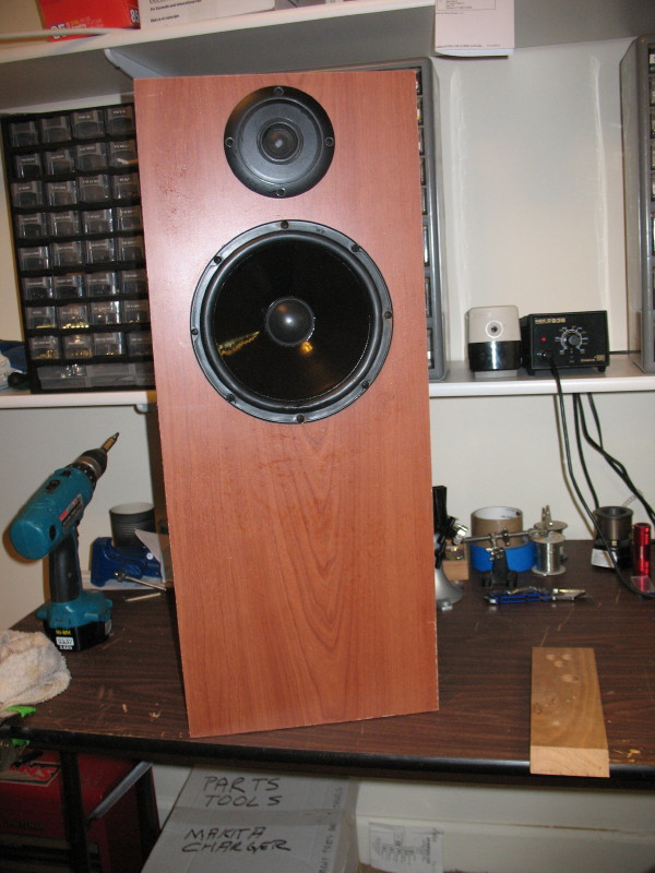

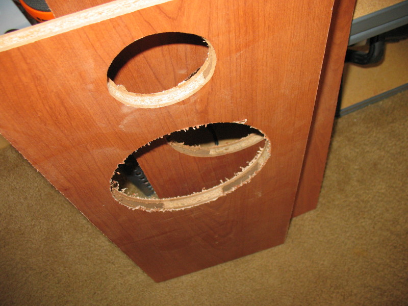

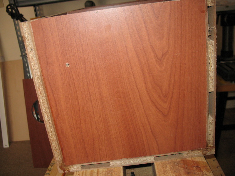

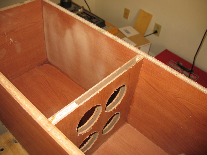

We really can't stress this enough!
index.php?t=getfile&id=775&private=0
index.php?t=getfile&id=776&private=0
index.php?t=getfile&id=777&private=0
Very Happy Very Happy Very Happy Very Happy Very Happy Very Happy Very Happy Very Happy
Just doin my part fer the invirument by re-cycling
index.php?t=getfile&id=778&private=0
First order 3000Hz cause I happened to have a cheapo Dayton 6.8uF in the drawer (That's kinda re-cycled, too) . Nooo, I haven't listened yet, the other is still clamped...stay tuned....

Wow, I've seen some voids in cheap plywoods but that's crazy!

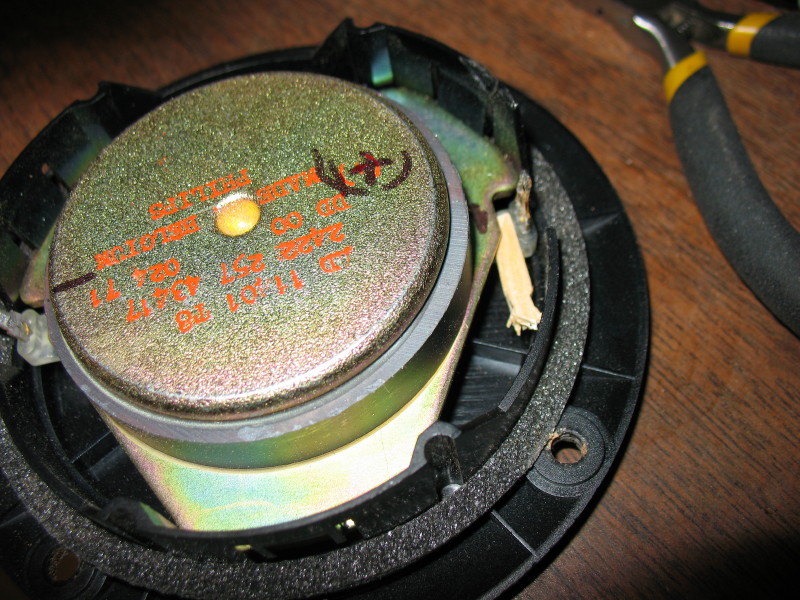

I had to do a repair to one tweeter, shimming the post so it made contact with it's...contact
index.php?t=getfile&id=779&private=0
And now....tadaaaa....I'm listening to Pandora for the first time w/o headphones and for computer speakers, plenty good enough. Total cost for drivers, crossovers and boxes: $28!
