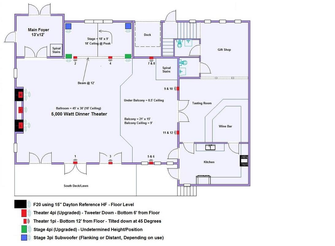

I am now entering the arena of trying to figure out how to power the three 4pi mains, twelve 1pi surrounds (and my four F20 subwoofers) that make up the sound for our winery's dinner theater. Any help anyone might offer in suggesting rack mountable pro amps that would be appropirate in driving these is greatly appreciated! I have attached images of what I am looking at so far, but I am somewhat new to the pro-amp stage and am in need of a little guidance.

(P.S. The "F20" subs will be using the 500W Dayton Audio RSS390HF-4 15" Reference HF Subwoofer @ 4 Ohm. "Lilmike", who designed the sub, said the enclosure is bandwidth-limited, and recommends a max of 300W per F20)
