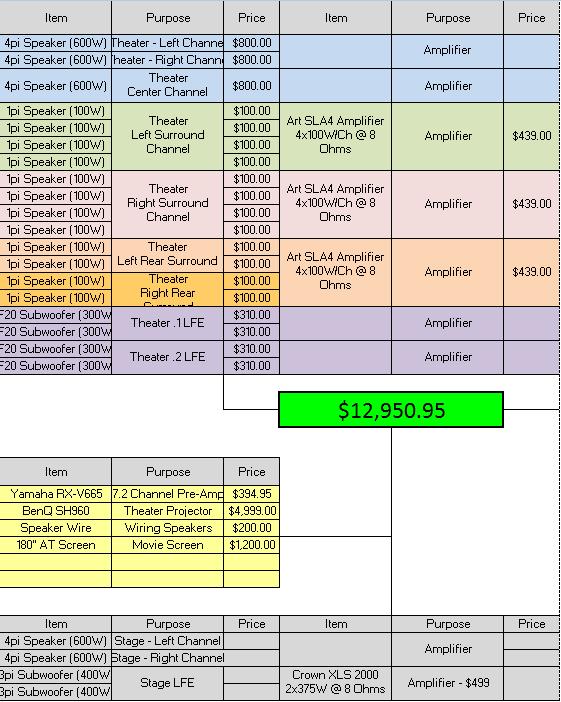

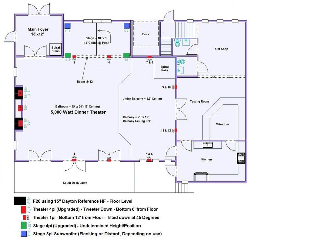

I am now entering the arena of trying to figure out how to power the three 4pi mains, twelve 1pi surrounds (and my four F20 subwoofers) that make up the sound for our winery's dinner theater. Any help anyone might offer in suggesting rack mountable pro amps that would be appropirate in driving these is greatly appreciated! I have attached images of what I am looking at so far, but I am somewhat new to the pro-amp stage and am in need of a little guidance.
Note: The 4pis will be using the JBL 2226h/B&C DE250 upgrades.
Also: I see the tweeter for the 1pi is 4ohm, and the woofer is 8ohm. Forgive a newbie question, but what ohm do I use for the amp that powers the pair?
-Jon Michael
(P.S. The "F20" subs will be using the 500W Dayton Audio RSS390HF-4 15" Reference HF Subwoofer @ 4 Ohm. "Lilmike", who designed the sub, said the enclosure is bandwidth-limited, and recommends a max of 300W per F20)
index.php?t=getfile&id=716&private=0
index.php?t=getfile&id=717&private=0

A few thoughts, in no particular order:
I'd run each of the mains on their own channels, and I'd run the surrounds in series / parallel if several were to be combined on each channel. Most prosound amps are pretty tolerant of their loads, but I'd still prefer to keep the load in the 4Ω - 8Ω range. I'd consider 2Ω to be a full stop limit.
It looks like you are planning to run each speaker on its own amp, which is even better than a series / parallel arrangement. I see no issues doing this.
The impedance of one π speakers is above 8Ω through most of the range. But it falls below 8Ω above 3kHz and by 6kHz, it's down to 4Ω. It begins to rise again at 12kHz. Down low, there are the customary peaks at resonance, but they're mild. See the chart at the link below:
Again, since you're planning to run each speaker off it's own amp channel, and each is rated for 8Ω, I think you'll have more than enough load capacity. Looks like what you have is a pretty conservative setup, with no amp being pushed too hard. All are well rated both in terms of impedance and power overhead.
If you were planning to push the system hard, I would suggest that you high-pass the mains and surrounds at their Helmholtz frequencies. But from the power levels you're talking about, none will be pushed hard. The amp will hit a clipping limit before the speakers hit their limits. That, of course, would cause more HF energy than normal, which would create thermal issues on its own. But that's another topic.
My expectation is that you won't be pushing the system to its limits, and if you find that you are, then you'll probably add speakers as well as amps. What you have looks pretty well matched, and should work well within its limits.

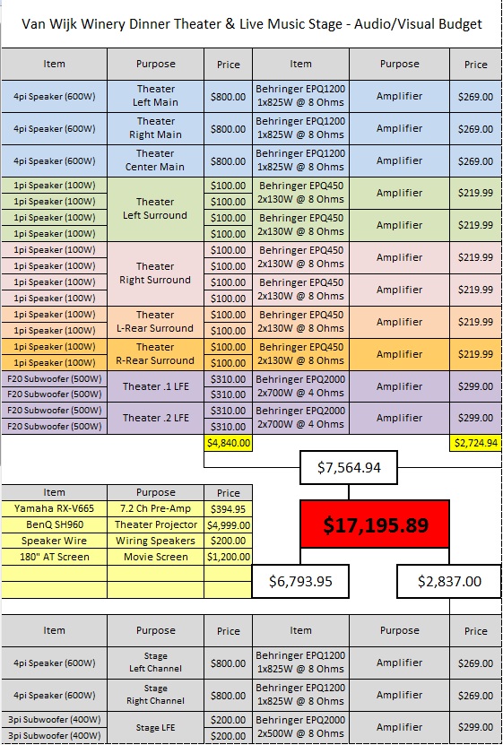

Does this look a little less conservative, but not over-the-top?
Anything I should be careful of if I use this configuration?
index.php?t=getfile&id=718&private=0
