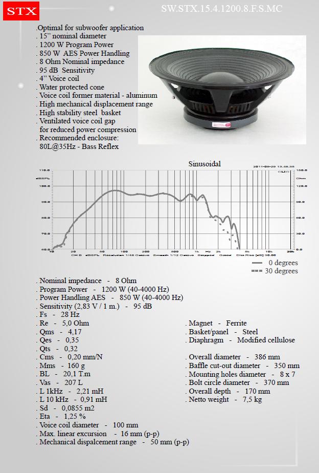

Thanks Wayne! I think I found my driver:
http://www.stx.pl/product/attachment/99b5b71954ed6694014cbedd15658d25/pl_PL/SW-STX-15-4-1200-8-F-S-MC.pdf

Re: Another Sub woofer Q&A [message #71134 is a reply to message #71130] Mon, 30 January 2012 10:07 Go to previous messageGo to next message
feket663 wrote on Mon, 30 January 2012 07:54
I couldn't open the attachment from that link, but I did find the driver here:
http://www.stx.pl/wm-stx-15-2-500-8-f-s-mc-duplikat-1.html
387 Zloty = 120 USD, not a bad price. Should do nicely, I think. Couldn't see the T/S parameters because the PDF file wasn't there. But hopefully you can tune it low enough for your needs without making the box too big.

Wayne Parham wrote on Mon, 30 January 2012 17:07
As an aside, I was in Warsaw a few times and when I left, I never exchanged my money. So I have some Zloty and Grosz coins. I kind of like having a little collection of interesting coins.
index.php?t=getfile&id=702&private=0
here it is!
  • Attachment: stx.JPG
    (Size: 89.61KB, Downloaded 5110 times)
Re: Another Sub woofer Q&A [message #71139 is a reply to message #71138] Mon, 30 January 2012 14:09 Go to previous messageGo to previous message
I must level with you. That woofer isn't a sub. It might be a fine midwoofer, because it is tuned like so many others that have been designed to run in 75-150 liter boxes tuned to 35-40Hz. This has become a defacto standard tuning for prosound midwoofers, and it works great for mains where the woofer will be used down to 40Hz or 60Hz or so. But it's really not the best choice for use as a dedicated subwoofer.
