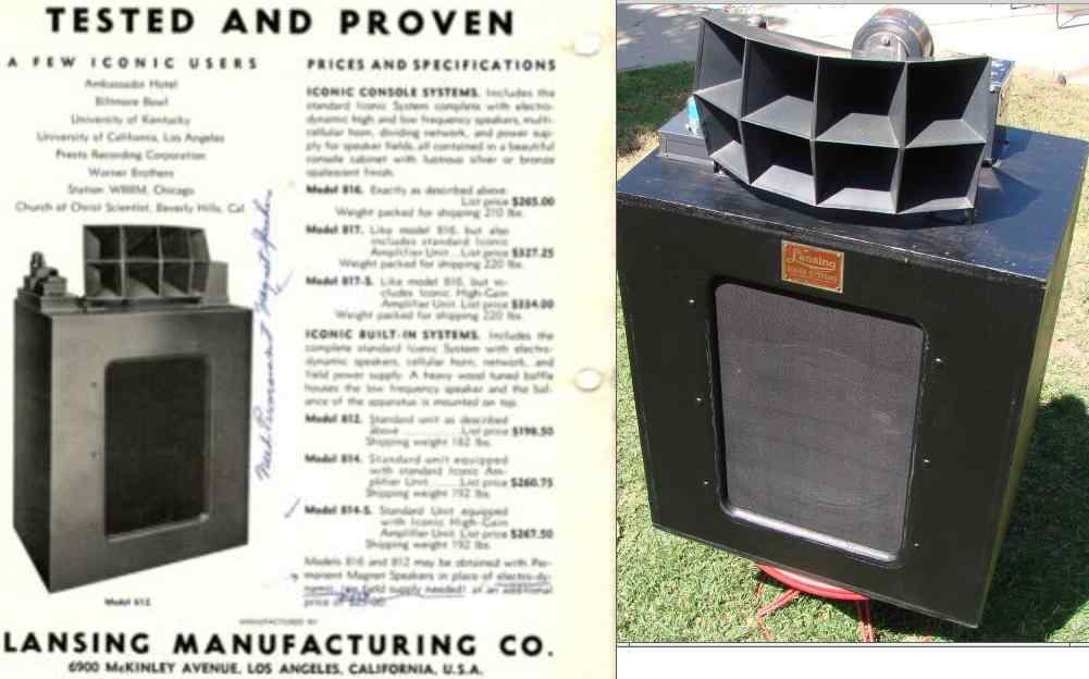

As near as I can tell, people have been making reflex + horn boxes for almost 80 years
index.php?t=getfile&id=670&private=0
The priorites have moved a few times already. But, save for adopting some whole other thing, why do people seem to forego wider range responses?
Even granting bunches of money--for example, those nice-motored midbass drivers are not so inexpensive--and we still need bass supplementation (?)
Do the current standards for acceptable clarity at higher efficiency preclude reaching lower even in giant boxes even when granted non-trivial expense?
I mean, why work soooo hard on driver spacing and phase and waveguides and all that--just to be band-limited and need one or both ends to be supplemented?
Is it just because the drivers don't sort neatly into higher-volume "pro" or "auto" categories so there's just not work being done in those areas?
At least these are what I'm wrestling with...not pointing at any one thing, just the "2-way way" in the higher-efficiency sandbox.
Thanks for the bandwidth, the time, and the education.
