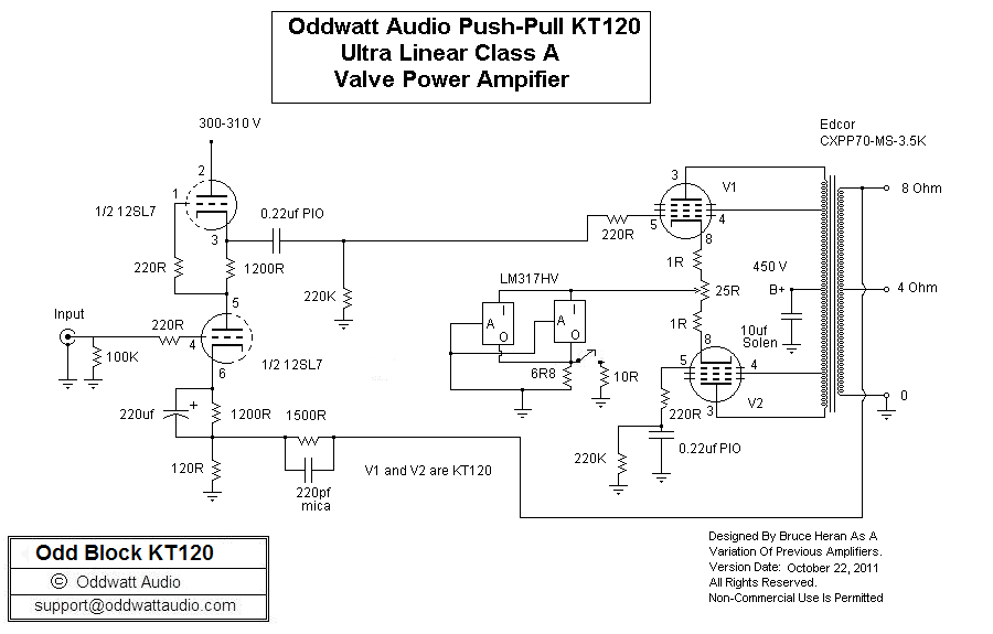

Dear Sir,
congratulations for your work...
I am amazed as you are using only one 12AX7 as a first stage Shocked
Could you please share schematic ?
Best regards from France 'n' happy christmas
Rock
Re: KT120 Class A Push-Pull U/L Mono-Blocks [message #70558 is a reply to message #70551] Wed, 21 December 2011 19:24 Go to previous messageGo to next message
Hi, If you keep a design clean and simple you do not need as much gain. My sense with many designs is they start out with a more or less standard configuration and then when it is built find flaws. They then add things to fix the flaws. My projects generally start out with an idea of what needs to be done. Then I figure out what configurations will do it best (at least in my opinion). Then I build it and do a lot of testing and tweaking to get it to do what it should. I use configurations that many designers shy away from for various mostly historical reasons. I am also not afraid of using solid state devices when I feel they will do best what I want. All the power supplies in my projects are SS, I use SS regulators in the B+ on the preamps and IC constant current sources in the power amps. Purists cry foul but the results are what I care about. A good example is the distortion level in the latest KT88 monoblocks. At one watt it is at the thresholds of what I can generate and measure (around 0.05%). I also strive for high signal to noise levels. My usual target is -90dbv. I don;t want any hum or noise at the speaker. So what all this means is that the power amp designs are deceptively simple. No parts that don't contribute to purpose. You will observe that there is only one capacitor in the signal path. Also I use a rather trivial amount of negative feedback (3-4 db) to insure stability with any kind of load, not to fix the distortion or frequency response as is often done in other designs. The various parts (like the particular transformers and capacitors)are chosen to work together. The end result is amplifiers that perform excellently. I have attached the schematic of the amp below. How you build the power supply is your choice, but it does need to be clean. I recommend against tube rectifiers because of their higher internal impedance, but with careful application they can be used.
index.php?t=getfile&id=659&private=0

Hi, Like you said nice clean designs. Tres bon. Smile We are clearly targeting different folks with our products though. Both in cost and tube vs solid state. I do some projects in SS and like them as well, just I like the challenges tubes present. I also like the sound. There are many individuals that say one kind of sound (SS, valve, triode, SE) is the best. I try to steer clear of that stuff. I just build and design what I like to hear without prejudice to what others like. Some folks like the same things and we sell kits to them (or freely give diy assistance on building from scratch). A bit OT here, but my two biggest passions are to (1) design audio equipment that excels and (2) to encourage new diyers to get into the audio field. If pressed, the second one is really the one I like best.

Hi Wayne, yes we had some early ones there. The present versions are far better. The originals were rather good, but the level of detail and "air" in the new ones is so much greater you would thing they are different amps. And as what would be obvious, they are really powerful. True to form, though, my belief in the first watt concept, they are quite clean at lower power levels. They just cross the 1% distortion level at 25 watts RMS. Smile Not to bad for a class A design. There is nearly 25 more on tap to keep your speakers busy.
