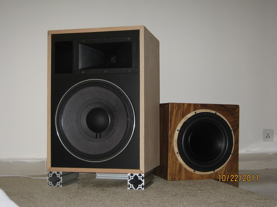

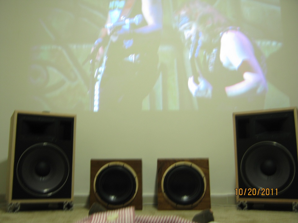

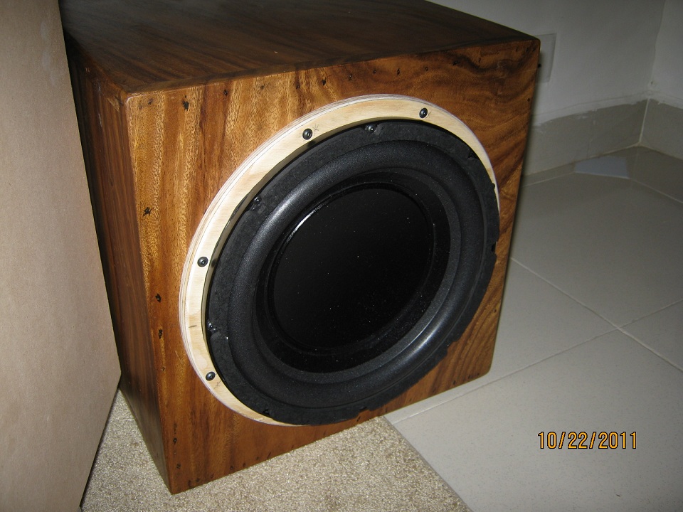

Here are pictures of the completed flanking subs, I think they turned out pretty well for less than $150/ea - Thanks Wayne!!!!
index.php?t=getfile&id=623&private=0
index.php?t=getfile&id=625&private=0
index.php?t=getfile&id=626&private=0
I have moved the subs to the final flanking position per the guidance of Wayne.

Wow, those look great!
Did the flanking subs measure/sound better set inside the mains rather than outside them? Sometimes they do work better inside, but not usually when they're that close together. I find in general, they work better placed inside when the right/left spread is wide and outside when the right/left spread is narrow.

Wayne, I was running the flanking subs on the outside of the left/right speakers as shown in the first picture. Basic room calibration was performed using Audyssey MultEQ in my receiver. I have ordered measurement capacity (Dayton Audio EMM-6 Electret Measurement Microphone, Nady SMPS-1X Phantom Power Supply, cables and microphone stand) so I can measure the in-room response using REW (http://www.hometheatershack.com/roomeq/).
I have moved the flanking subs to the inside as pictured, but spread the left/right further apart. I like this sound better as the soundfield is wider and the bass response did not audibly change significantly.

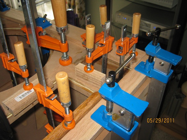

Going back, what of the long clamps would you recommend for box building?
http://audioroundtable.com/forum/index.php?t=getfile&id=447&private=0

I bought my clamps from Harbor Freight. The 36" bar clamps (blue) worked well, they are not as good as Bessey clamps but the cost differential is about 3:1. The smaller clamps also worked well (Harbor Freight). The hand-ratchet clamps they sell are complete crap, for that style I will stick with Irwin.
If I had an active woodshop I would probably buy Bessey clamps - the one that I have is clearly better made than the the harbor Freight clamps. But for building a few speakers from time-to-time the Harbor Freight clamps work fine, for the price they are hard to beat.

Thanks. I ordered some of the blue ones.
