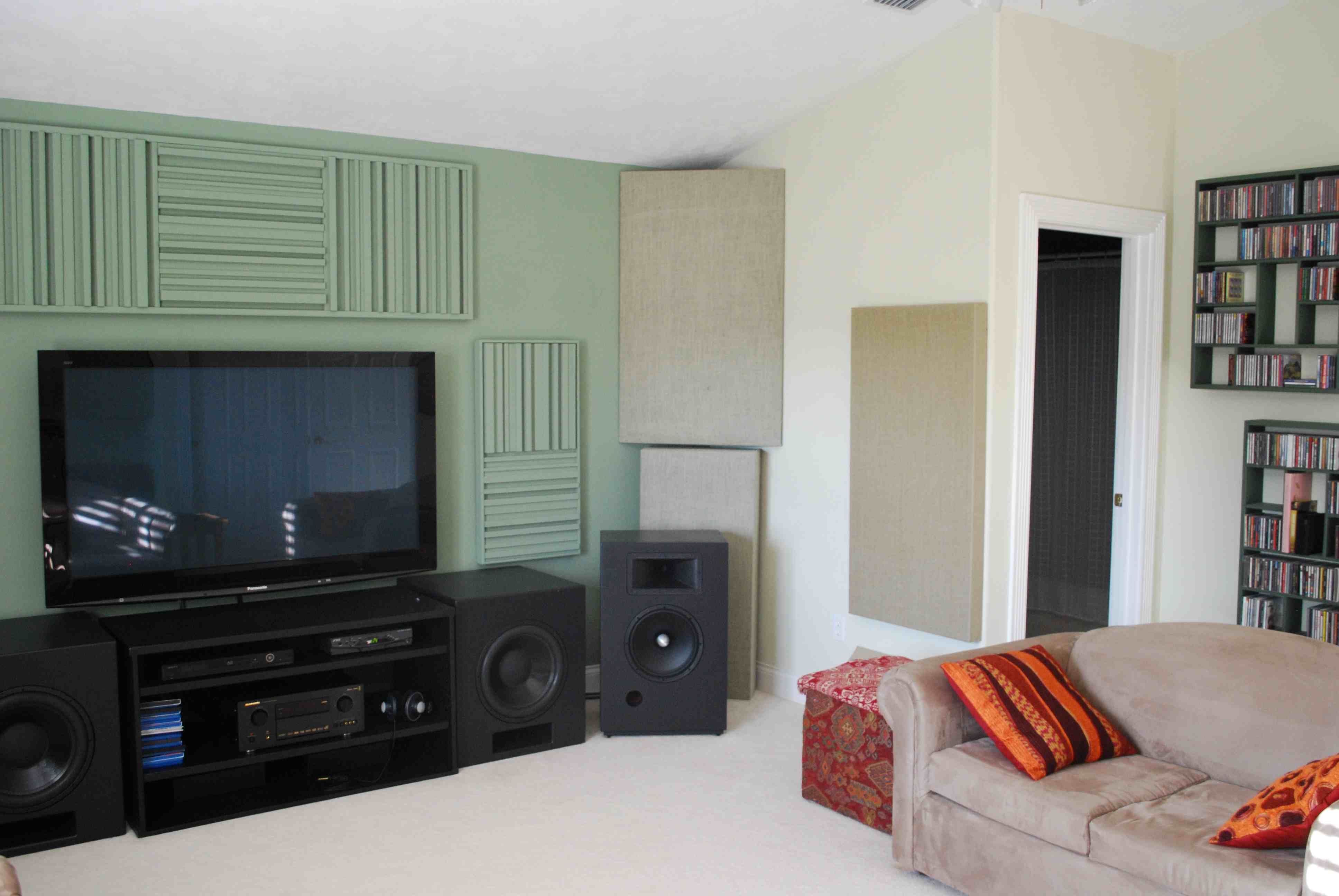

Re: 6 Pi [message #70076 is a reply to message #69840] Wed, 09 November 2011 07:41 Go to previous messageGo to next message
Messages: 78
Location: Florida
Here is a photo of the room with the "short" corner. How do you think the 6Pi might fare?
index.php?t=getfile&id=635&private=0
  • Attachment: DSC_0001.jpg
    (Size: 273.40KB, Downloaded 4427 times)
Re: 6 Pi [message #70078 is a reply to message #70076] Wed, 09 November 2011 12:44 Go to previous message
That will work. Obviously, we'd prefer a symmetrical pair of corners, but that's enough wall space to form waveguides for the range that matters - the range above the Schroeder frequency. Below that, room modes set the pattern anyway. Put subs in opposite corners or wall midpoints on each side and you'll have that part covered too.
I see you have flanking subs in that photo - which is the best thing to do with your three π speakers. Constant directivity cornerhorns are a little different though. They have no need for flanking subs, because there is no reflection from the wall behind the speaker and the midhorn and woofer blend to smooth vertical modes.
So if you go with six π cornerhorns, put the subs elsewhere. As I said above, opposite corners or wall midpoints often work best. You'll also want low-pass to be at a lower frequency for these more distant multisubs than you would with flanking subs. We're looking to them to smooth the range a little lower in frequency.
