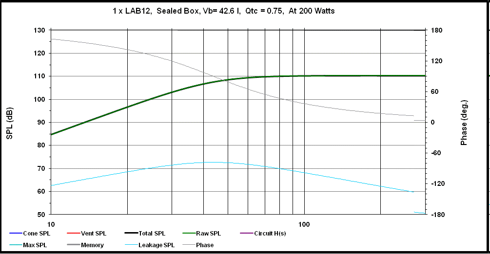

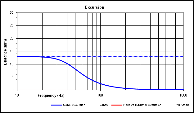

Just ordered two of the 3 Pi subwoofer kits. Laughing Laughing Laughing
I am having a local Cambodian furniture maker build two 16" x 16" x 16" boxes from 1" thick plywood for $50.00. I am sure it is not going to be baltic birch at that price, but should be good enough to last the two years I am over here.
Sealed box is 1.5 ft^3 with a Qts of 0.75. Calculated relative -3 dB Point = 42.19 Hz, -6 dB Point = 32.59 Hz and 10 dB Point = 24.93 Hz; should be more than adequate for flanking subs.
index.php?t=getfile&id=585&private=0
index.php?t=getfile&id=586&private=0
Does the kit come with binding posts?

That smaller box should work nicely for flanking subs, even with f3 around 45Hz. Then later, when space permits, you can build the 20"x20"x20" box shown in the plans for 20Hz extension.

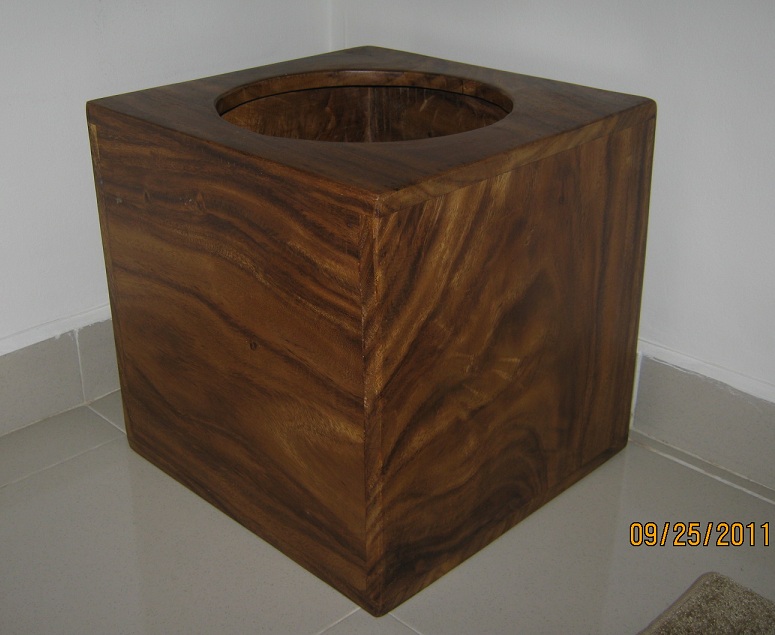

Picked up the 16" boxes yesterday. One is pretty much perfect:
index.php?t=getfile&id=601&private=0

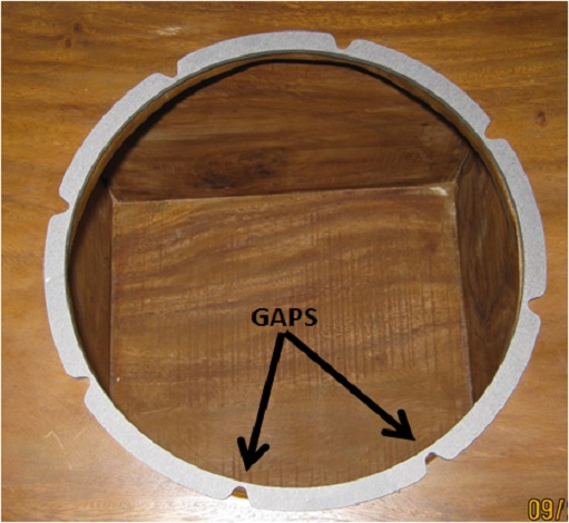

However, this one has the hole cut to large:
index.php?t=getfile&id=604&private=0
I can take it back to have it remade, but I would REALLY hate to make her eat the cost as the people here barely make any money.
I think I have three options,
1) Clamp the gasket to the box and fill in all the gaps behind the gasket with a hot glue gun. Would seal the two screw holes that would leak. Not sure how durable of a solution this would be in the long run. However, I am planning on building new boxes when I return to the States.
2) Take the box back and have her replace the front baffle. These seem really well made (except for the cutouts which were made by hand without the use of power tools - no jig saw or router which led to the error in sizing) so I am not sure how easy it would be for her to replace just the baffle. It is a 16" x 16" size, so it could be cut off I suppose.
3) Have her add a new front baffle over the existing one on both boxes. I think 1/2" thick should be sufficient. I think this would be the easist on her end and cost her the least amount of money.
Anyone have other suggestions? Would #1 work?

The sub boxes look nice. Sorry about the misshapen woofer cutout.
NWCgrad wrote on Mon, 26 September 2011 02:41
That's the route I would take. Wouldn't be hard to do even with the crudest hand tools and it solves the problem without being a potentially troublesome or ugly compromise.
