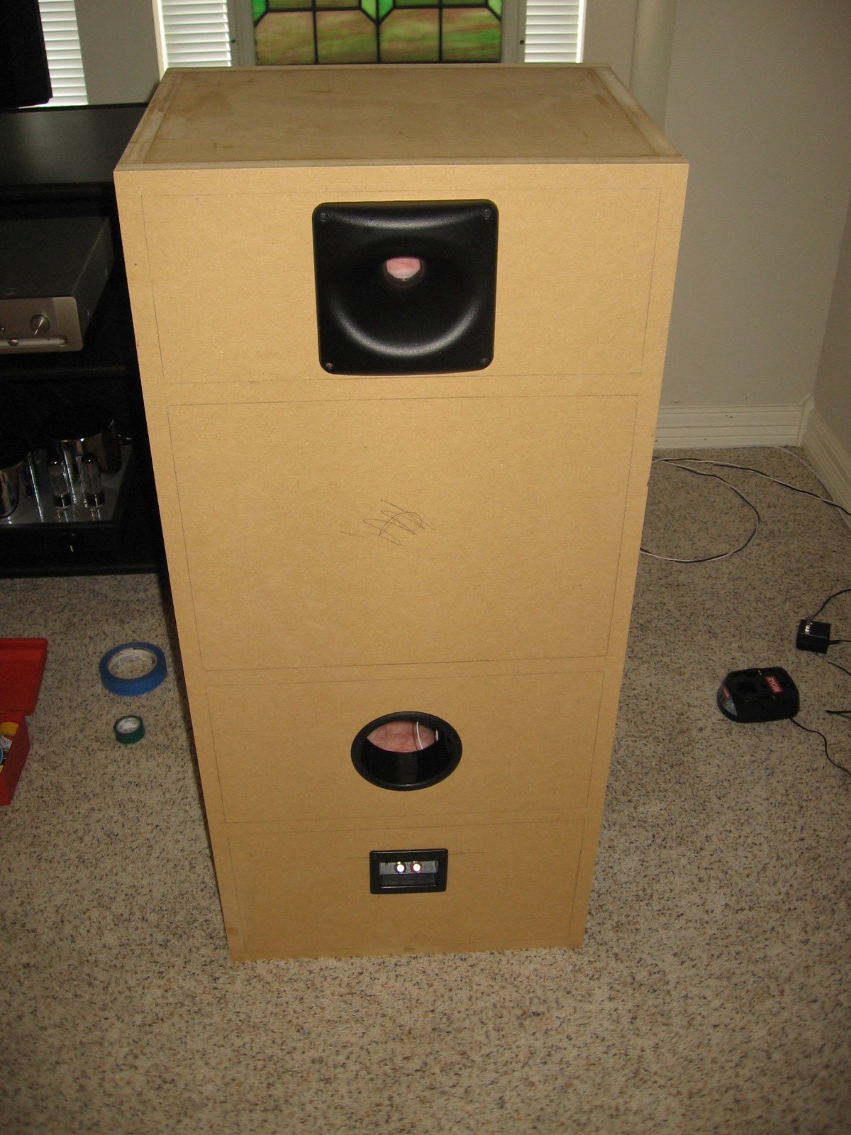

Here's a picture of the back of the new enclosures showing the waveguide, the 4" port and the speaker terminals. A miniature switch on the speaker terminals allows me to turn the rear firing tweeter on or off:

Re: The AudioKarma Econo-Waveguide Speaker [message #68085 is a reply to message #68084] Tue, 07 June 2011 18:19 Go to previous messageGo to next message
Messages: 19101
That larger box looks great! I'll bet it sounds good too.
