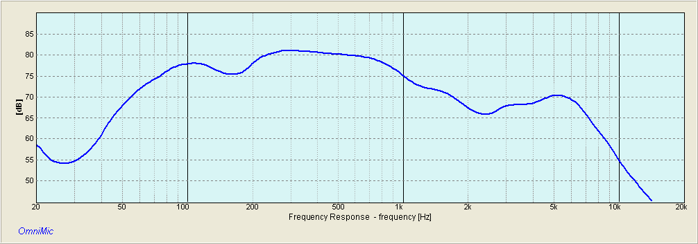

Got them all together, and I'm pleased with the sound considering they cost about $100 to build. I also did some measurements, which are critical in designing a crossover. When you're talking "line array" you can forget about using a crossover design program, because woofers behave very differently when they are arranged in an array versus a point source.
Here's the in-room frequency response of one woofer measured at one meter. It's the one directly below the tweeter. No other drivers are connected. Notice the peak between 5 and 6khz. Any crossover you designed for this woofer would have to attenuate that peak.

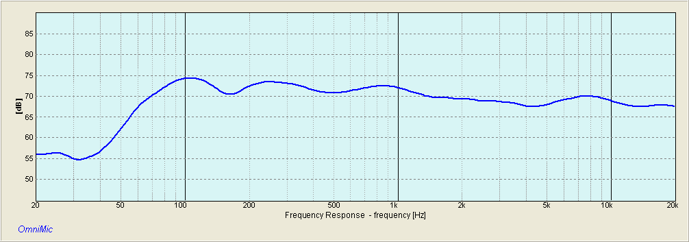

Now here's the in-room frequency response of the twelve woofer array measured at one meter. Notice what's happened to the frequency response versus the single woofer.

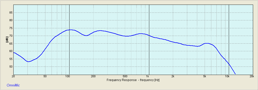

But you don't listen to a line array at one meter. The listening position distance should be at least the length of the array, and ideally more than that. So here's the same in-room response of the twelve woofer array measured at the sofa, which is ten feet from the speakers. You can still see the 5-6khz peak, but the overall response is much smoother at this distance.
It is now possible to see how you could include a tweeter that would integrate fairly well with this array, but it's obvious it will need a low fs for a crossover frequency no higher than 2khz, it will have to be fairly efficient to match the woofer arrays's sensitivity, and you will need to use a higher order crossover to get it to play fairly loudly down to the crossover frequency.

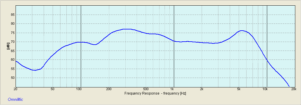

The tweeter also needs to be inexpensive. Forget about ribbons or horn-loaded compression drivers. Any good one would be too expensive. Enter the Vifa XT25. Low resonant frequency, high sensitivity. It also has a reputation for being very robust, and important feature for a tweeter that must match twelve woofers without breaking a sweat. Here's the array with the XT25 and a third order crossover (electrolytic caps, of course, because it must be inexpensive). I also experimented with tweeter attenuation resistors and found I like a 1.5 ohm resistor ahead of the tweeter crossover, which is included. The tweeter caps are a 15uF and a 31uF. The inductor is a 0.15mH. The woofer array is wired directly with no filter.
