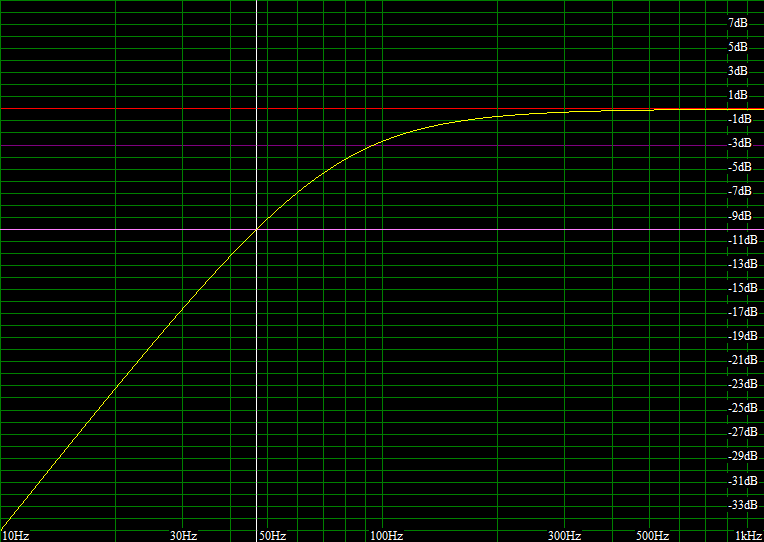

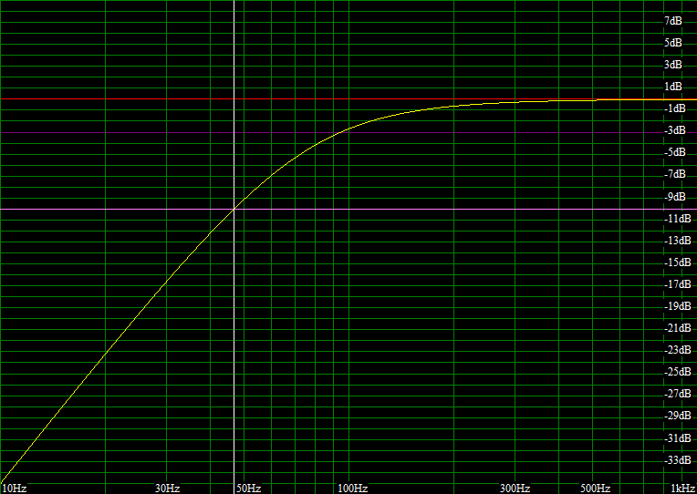

Sealed? Did someone say sealed?
index.php?t=getfile&id=571&private=0
JBL 2226H, 2.5 cu ft, sealed; F3=91.3 Hz, F6=83.5
That would be technically known as "Jack Sprat Bass"
