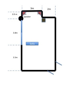

Dear Wayne,
I would like to ask if 7Pi speaker can be used in my room. I have an unusual shape room. It is an open space house and I only have space to put speaker as shown in the red triangle corners. Sorry for the unit in metric. I hope you don't mind.
Thanks so much, I already got your 7pi plan in mail.
index.php?t=getfile&id=569&private=0
  • Attachment: floorplan.jpg

I don't think you'll be as happy in those corners as you would be with them in the corners at the opposite end of the room.

I can not though The low left corner has doors that open to other room.

I'd suggest three π or four π speakers then, with flanking subs, of course.

May I ask for 4Pi speaker plan please. I already own JBL 2226.
For "flanking subs", what do you recommend? 2 subwoofer below each speaker or more sub around the room.
Re: 7Pi in unusual room [message #68961 is a reply to message #68957] Wed, 10 August 2011 08:11 Go to previous message
You've got mail!
Three π subs are an excellent match with four π mains.
