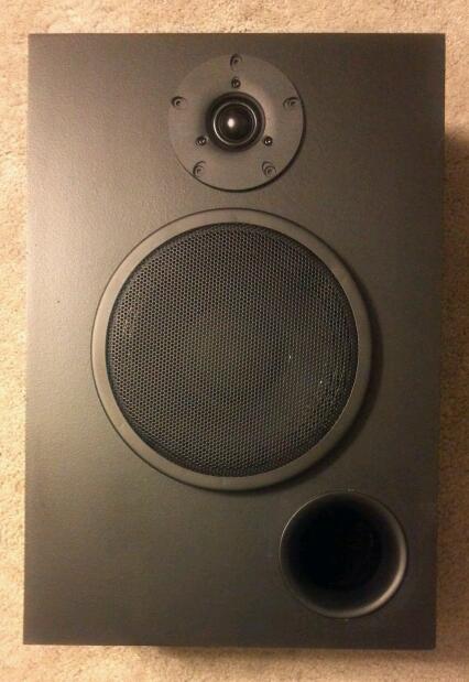

Re: Grills for your 1pi? [message #71569 is a reply to message #68670] Tue, 28 February 2012 22:41 Go to previous messageGo to next message
Messages: 102
Registered: June 2011
Location: Iowa
Not screwed down yet, but this is how they will look. Smile

Re: Grills for your 1pi? [message #71584 is a reply to message #71569] Wed, 29 February 2012 14:17 Go to previous messageGo to previous message
Looks nice!
We need to get some silver logos for you. We always include black logos in the kits, unless otherwise specified. I guess we should probably tell people to let us know when they plan to build 'em black so we can send out silver logos instead.
