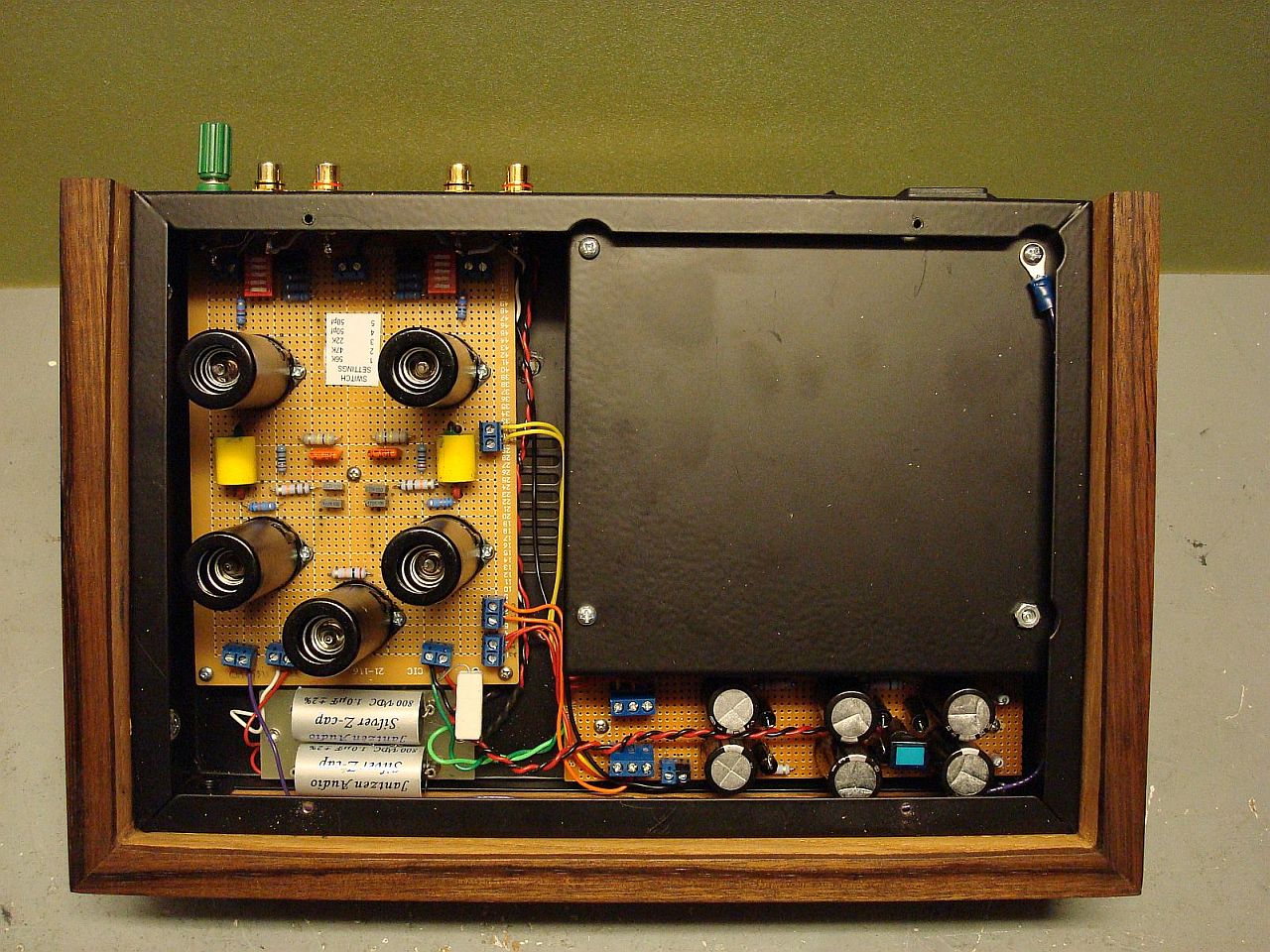

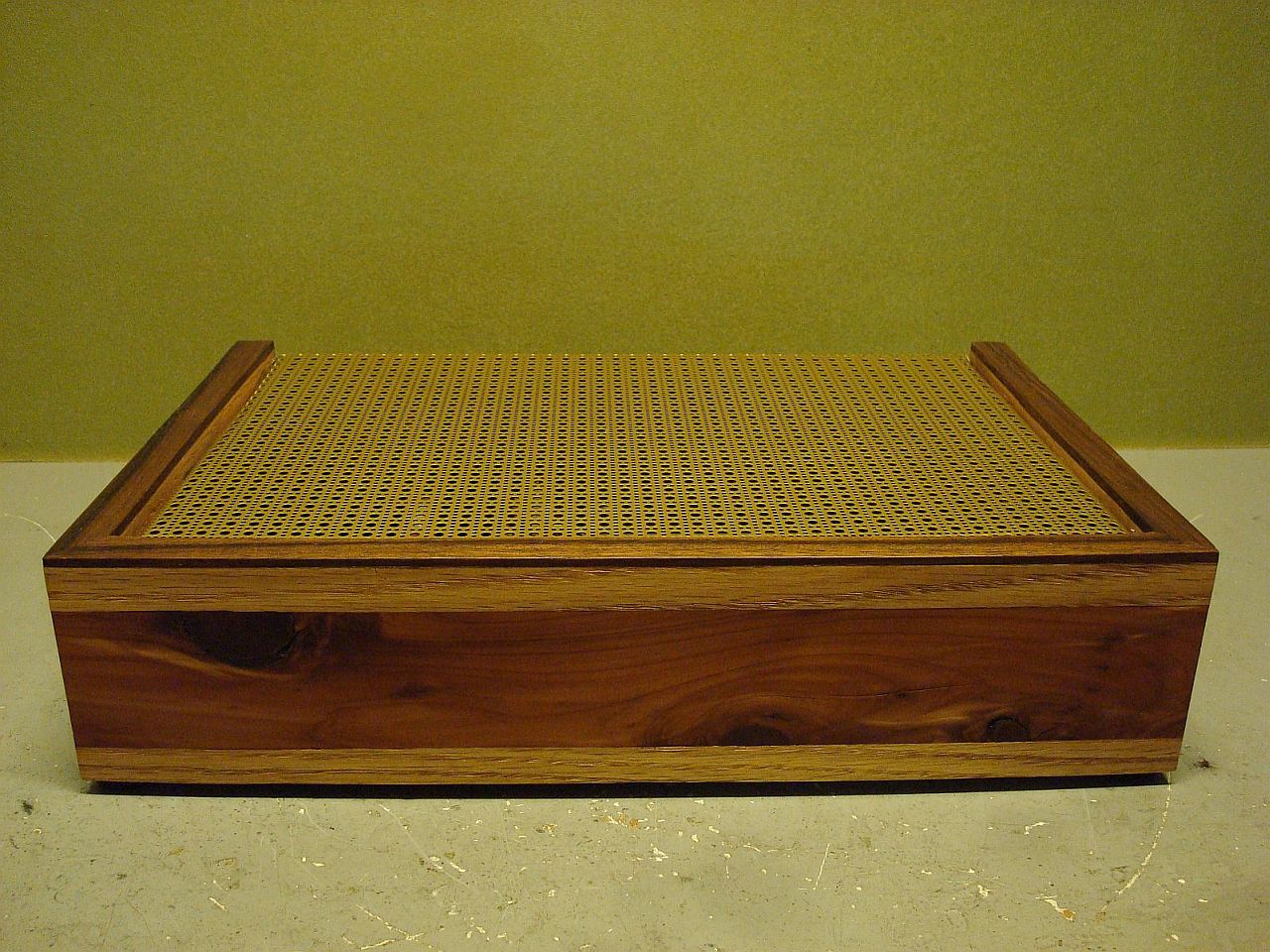

Messages: 2059
Hi Everyone, Just a pair of photos of the latest incarnation of the preamp. Tube brands and types have mattered. The quietest ones so far are JJ gold pin ECC83S with the ECC803S close behind. Others (Tunsol, Mullard new production and EH) were not as good.
