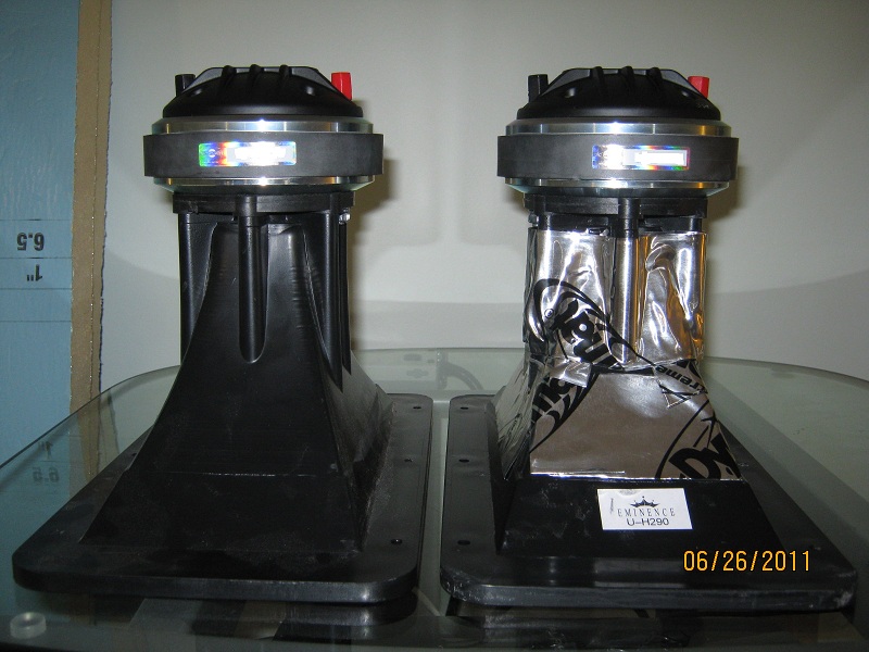

First, covered the H290 horns with Dynamat I had leftover from a car stereo install:
index.php?t=getfile&id=525&private=0

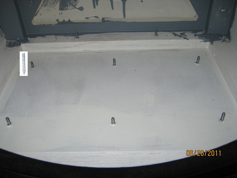

Added hanger bolts to bottom of cabinets for the crossover and 100W resister:
index.php?t=getfile&id=526&private=0

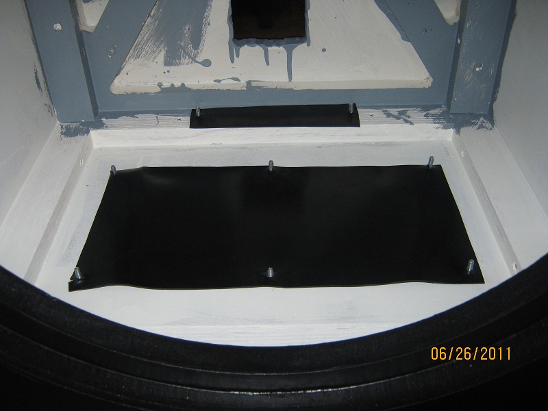

Cut rubber (1/16" thick) as gasket, pushed over the hanger bolts:
index.php?t=getfile&id=527&private=0

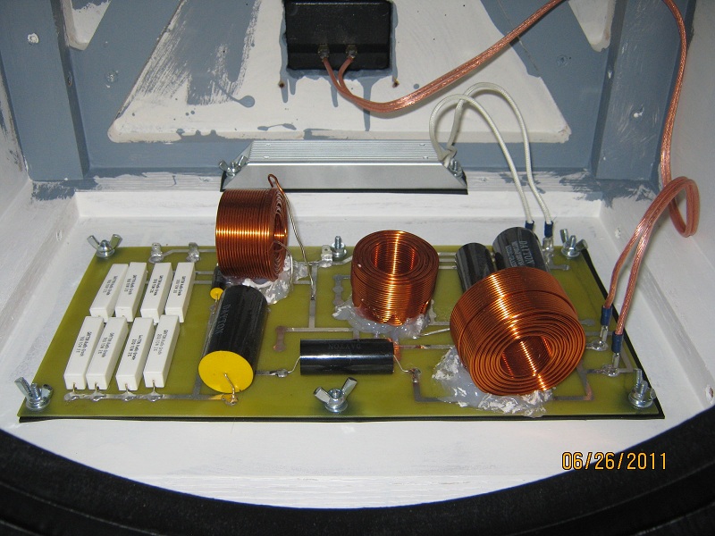

Bolted on crossover and 100W resister:
index.php?t=getfile&id=528&private=0
