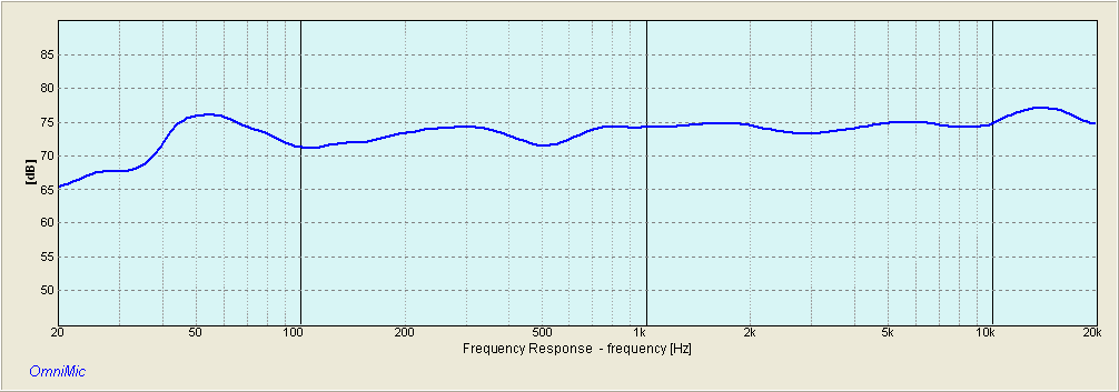

So I completed my Indignia pair a few days ago and they sound wonderful, with good but not exaggerated bass, midrange and treble to die for, and a great soundstage. The only downside is that they achieve this at the cost of efficiency, and they can play only so loud before the woofer runs out of steam and starts to make noise. They are not a party speaker, but they're great for listening at reasonable volume levels.

Here's the measured in-room response in my relatively small upstairs listening room (1/3 octave smoothing, microphone placed at tweeter level at one meter):
index.php?t=getfile&id=513&private=0
  • Attachment: Indignia.bmp
    (Size: 1.35MB, Downloaded 9833 times)

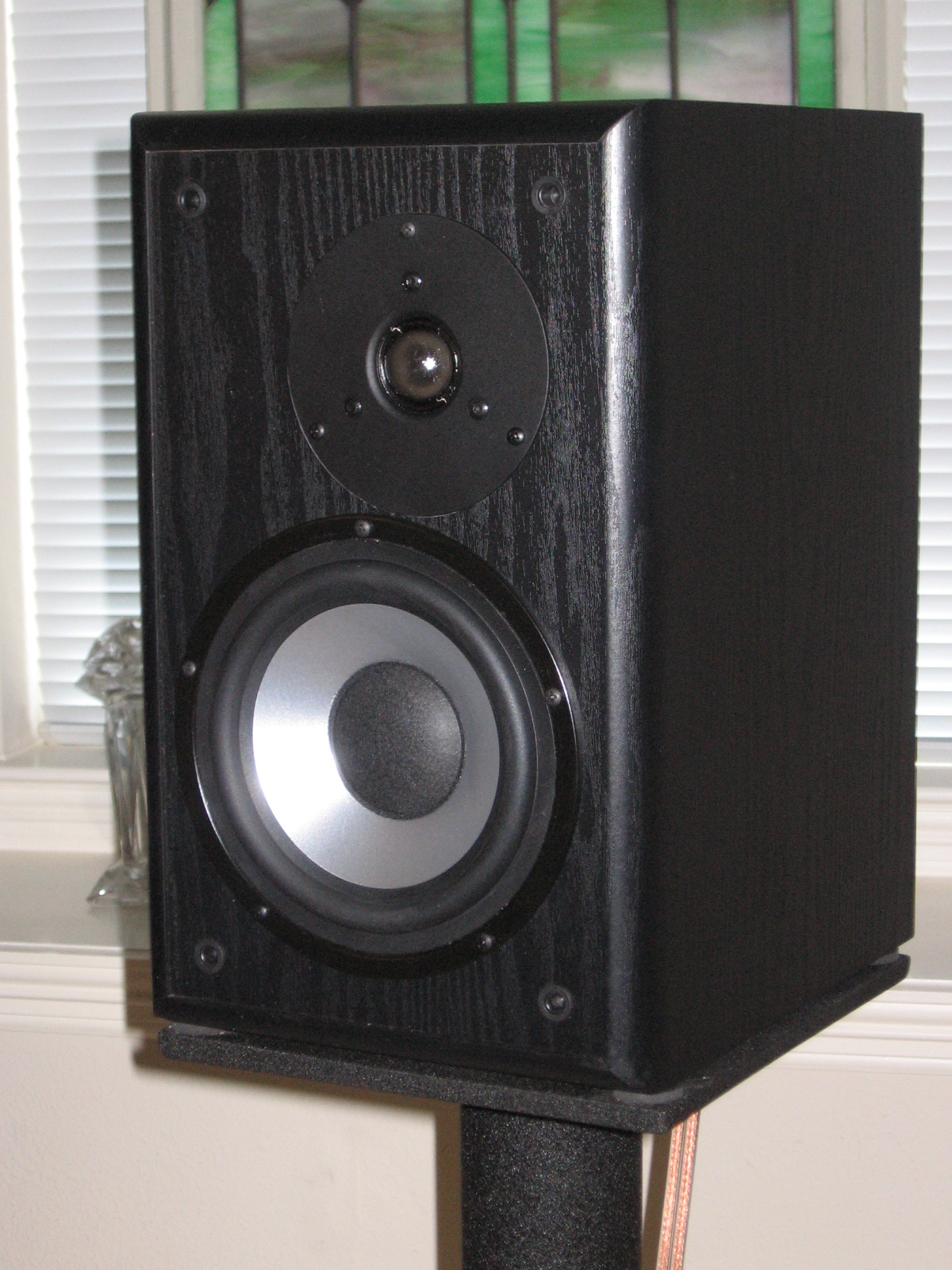

Here's a picture of an Indignia built into the BR-1 enclosure:
index.php?t=getfile&id=514&private=0
  • Attachment: 003.JPG
    (Size: 530.73KB, Downloaded 9599 times)

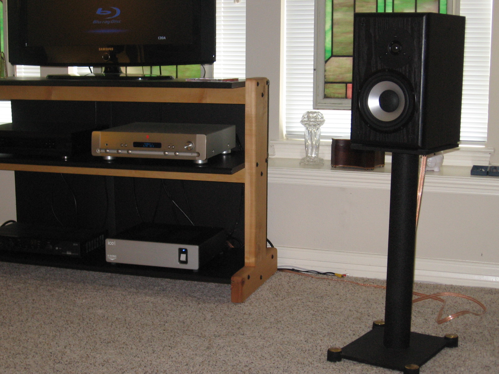

And here's a picture of the Indignia in the system. Yes, the 500w/ch IcePower amp is a bit of overkill Laughing
index.php?t=getfile&id=515&private=0
  • Attachment: 002.JPG
    (Size: 495.61KB, Downloaded 9514 times)
