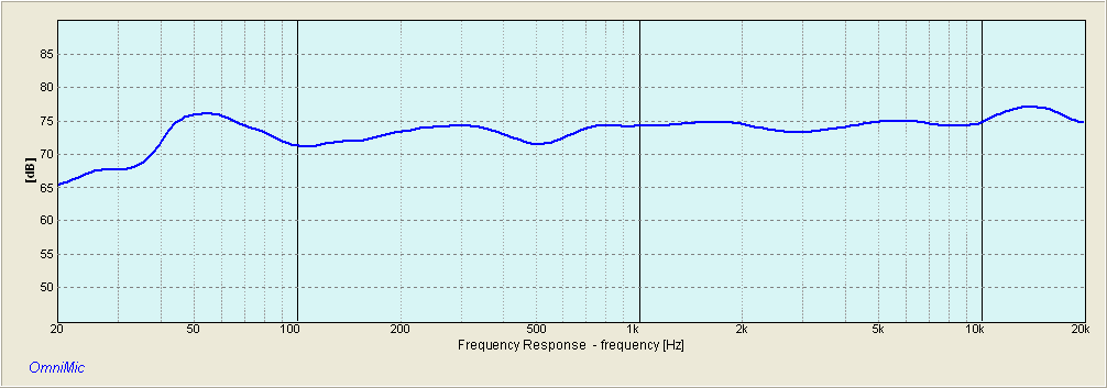

Here's the measured in-room response in my relatively small upstairs listening room (1/3 octave smoothing, microphone placed at tweeter level at one meter):
index.php?t=getfile&id=513&private=0
  • Attachment: Indignia.bmp
    (Size: 1.35MB, Downloaded 9831 times)

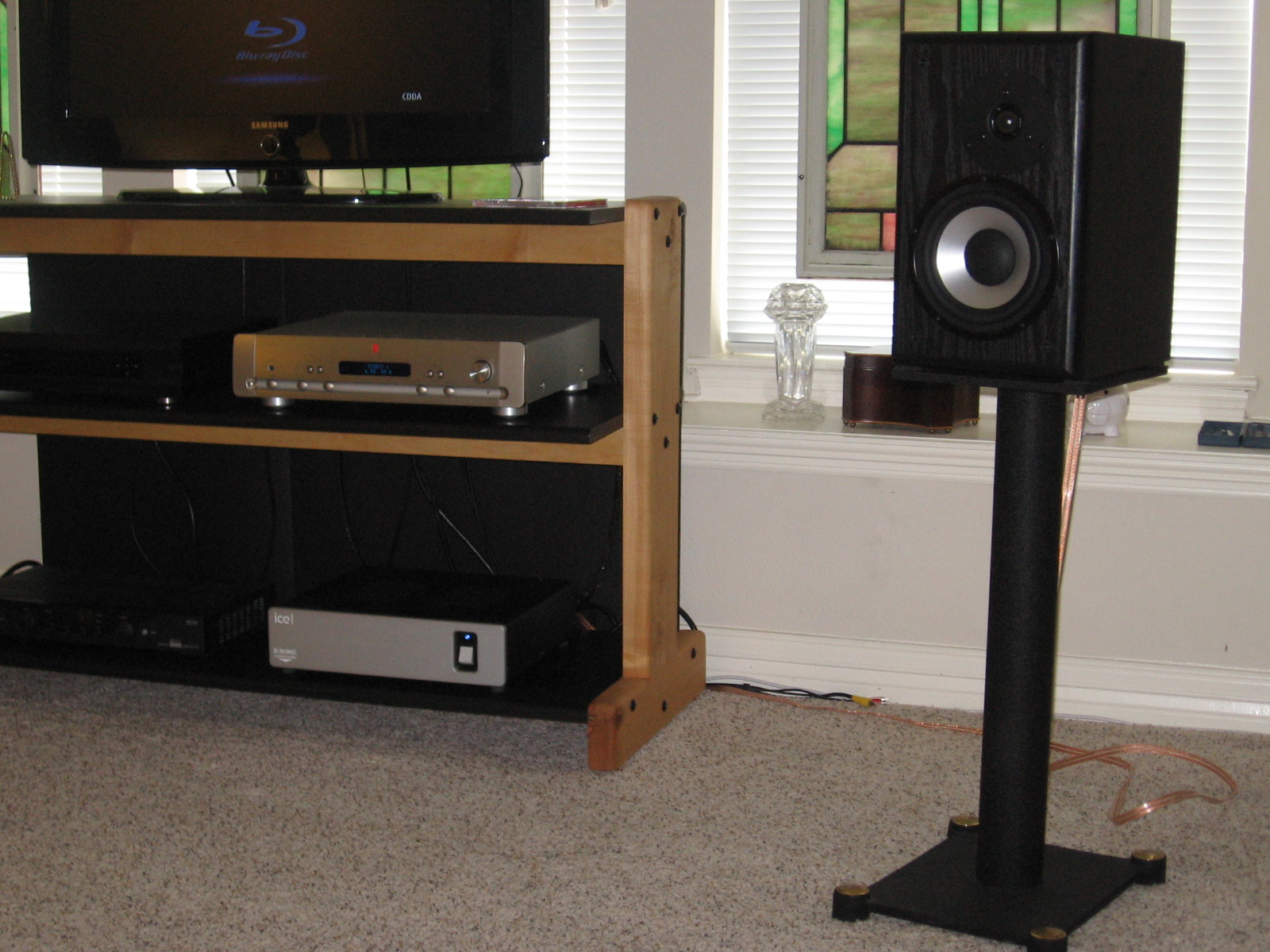

Here's a picture of an Indignia built into the BR-1 enclosure:
index.php?t=getfile&id=514&private=0
  • Attachment: 003.JPG
    (Size: 530.73KB, Downloaded 9598 times)

And here's a picture of the Indignia in the system. Yes, the 500w/ch IcePower amp is a bit of overkill Laughing
index.php?t=getfile&id=515&private=0
  • Attachment: 002.JPG
    (Size: 495.61KB, Downloaded 9513 times)

Really neat looking little speakers, Fred. Nice for surrounds or mini-monitors for a small system. Do you happen to know the sensitivity?
Re: The Karma Indignia [message #68262 is a reply to message #68261] Mon, 20 June 2011 10:23 Go to previous message
Messages: 377
Location: Houston
Wayne Parham wrote on Mon, 20 June 2011 09:21
The woofer's sensitivity is advertised as 85dB. So when you place a 1.5mH iron core inductor with 0.22 ohms DCR it probably will be in the 84dB range. Flea power tube amps need not apply for the job of driving these speakers, but the typical owner will be using a 100w/ch mass market receiver, which will drive these 8 ohm speakers ok.
