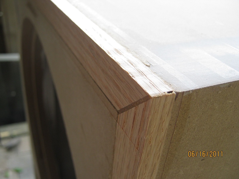

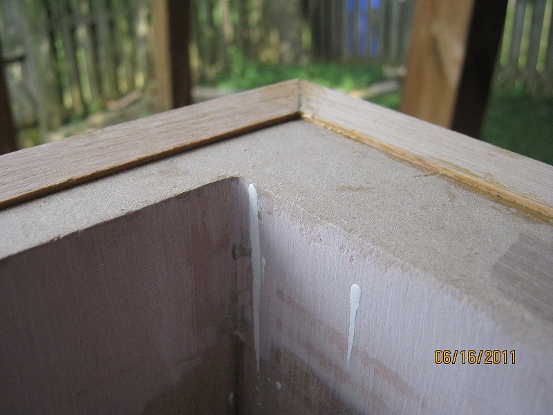

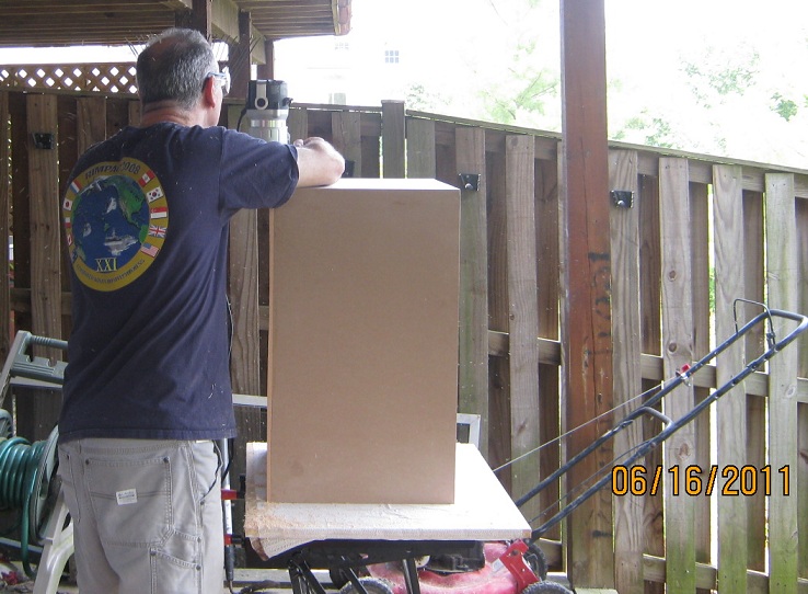

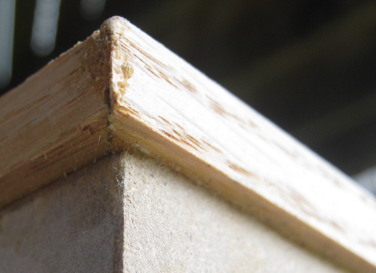

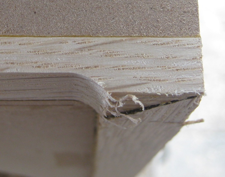

First, routered the edges of the oak trim glued to the front panel. The oak strip was both thicker and wider than the intended space to account for "variations."

After flush trimming the oak the speakers looked MUCH better, I was a little concerned about the process but it worked great. A little woodfiller and a lot of sanding followed.
