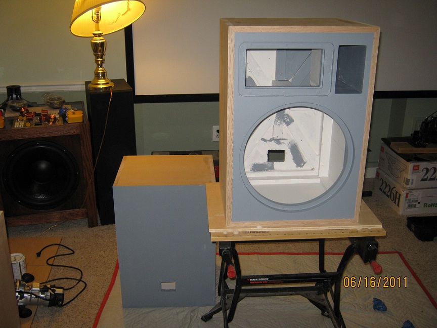

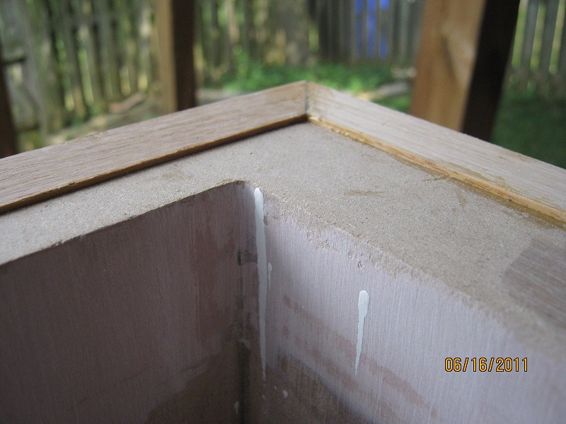

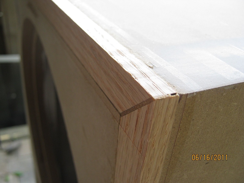

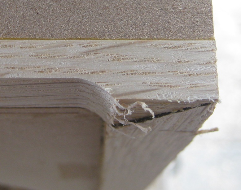

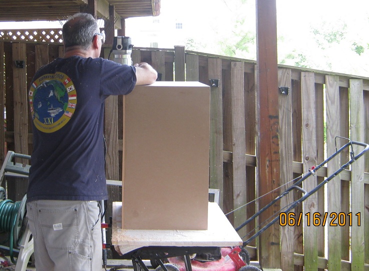

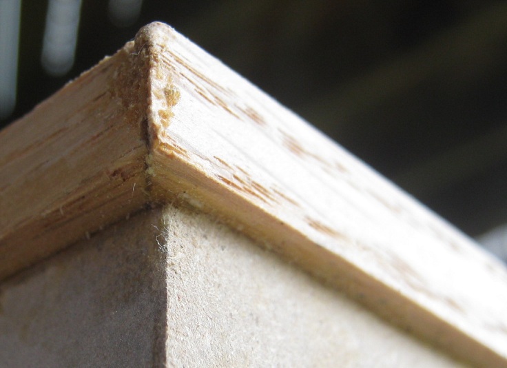

First, routered the edges of the oak trim glued to the front panel. The oak strip was both thicker and wider than the intended space to account for "variations."

After flush trimming the oak the speakers looked MUCH better, I was a little concerned about the process but it worked great. A little woodfiller and a lot of sanding followed.

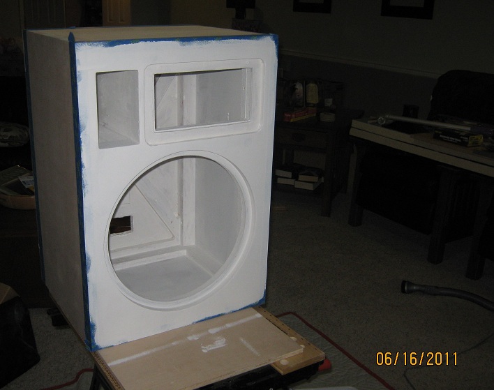

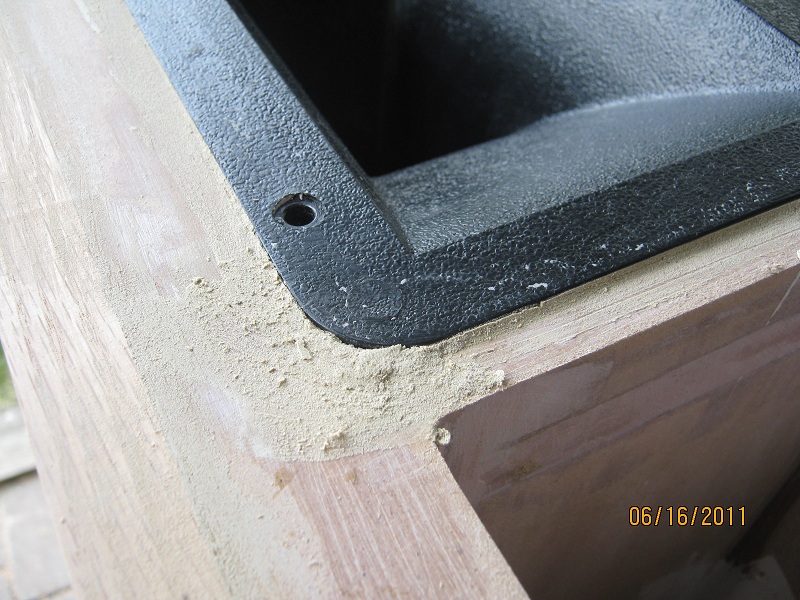

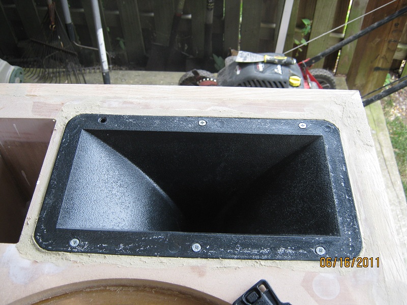

Next, I used woodfiller to augment the bondo used last week to enable a better fit of the waveguide.
index.php?t=getfile&id=502&private=0
index.php?t=getfile&id=503&private=0
Not yet perfect, but it is getting better.

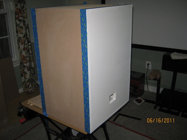

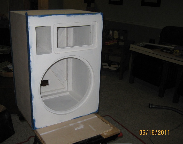

Finally, two coats of primer (first coat white and second coat gray). Starting to see the light at the end of the tunnel.
index.php?t=getfile&id=504&private=0
index.php?t=getfile&id=505&private=0
index.php?t=getfile&id=506&private=0
index.php?t=getfile&id=507&private=0
Tomorrow - or Saturday - will veneer the cabinets. Going to try the "Better Bond Titan DX™" Contact Cement from veneersupplies.com. Since most of the work is in my home theater I wanted to avoind VOC's, reviews of Titan DX on the net have been good, so I decided to go for it. Also, need to sand the primer and add a third coat.
The plan is to paint the front/rear baffles and stain/seal the veneer once I arrive in Cambodia, not enough time for paint/polyurethane to cure before they will be packed for shipment.

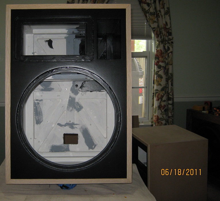

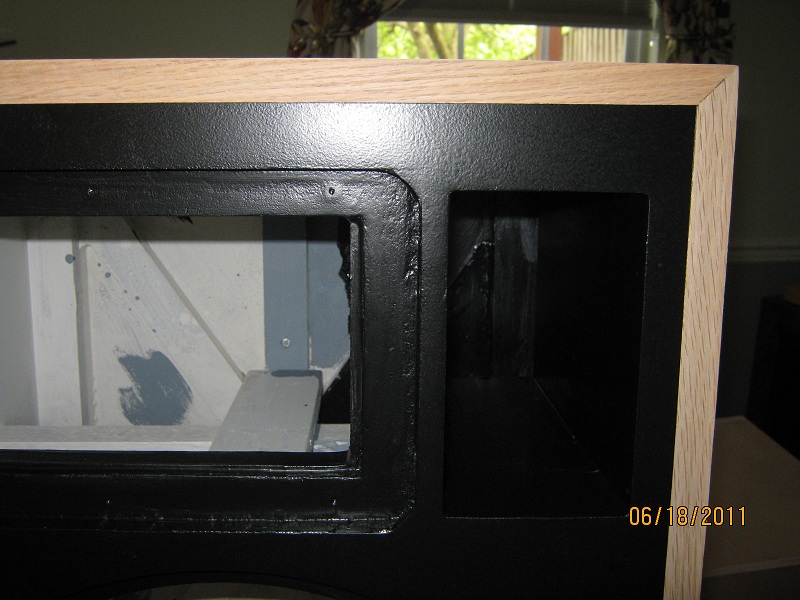

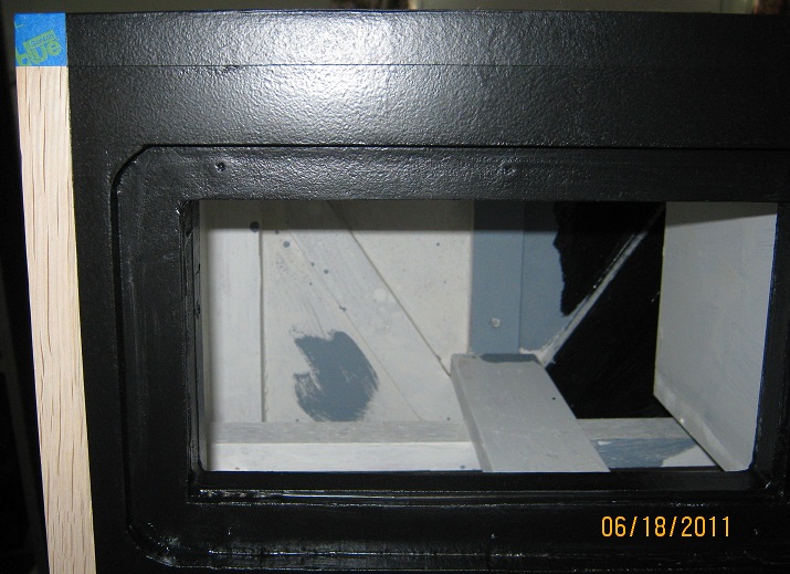

Due to the high volume of moves in the DC area, my packout is most likely to be pushed back by at least two weeks. So....
index.php?t=getfile&id=509&private=0
index.php?t=getfile&id=510&private=0
index.php?t=getfile&id=511&private=0
index.php?t=getfile&id=512&private=0

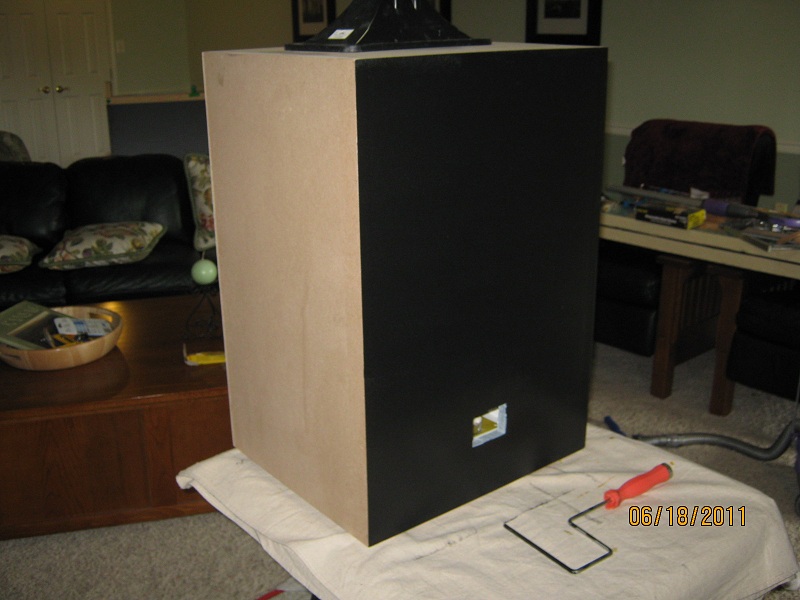

Sanded the primer and painted front/rear with two coats of BEHR PREMIUM PLUS® Exterior Satin Enamel. I will let it cure for a week before veneering the remainder of the cabinet.
