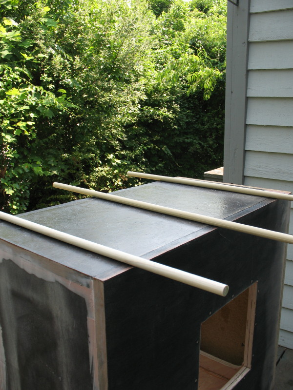

Just like with the NBL wood veneer, 2 coats of contact adhesive go on both surfaces, waiting for each coat to dry enough so that, while tacky, your finger will not pick any up. BTW, when applying the adhesive, go a little heavier on the edges of the workpiece which always seem to cause problems otherwise.
Now the dowels get placed to keep the glued surfaces apart during alignment. Different strokes, here, but I use dowels because of their minimal contact with the surface which makes pulling them out easier. 1/2" dowels seem to be the optimum size: large enough to maintain the separation, small enough to allow the eyeball to get a good picture of the alignment.
index.php?t=getfile&id=480&private=0

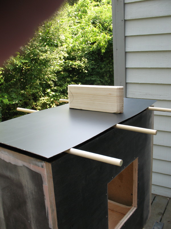

When I line up the Formica or veneer, I take my time and walk around as many as 3 times, double-checking after each minor re-position that a movement one way hasn't left a gap in another. There's only one chance to get this right!
index.php?t=getfile&id=481&private=0
Once aligned, I remove an inner dowel to start. The soft pine wood block, cut from an ordinary 2X4, is the "squeegee" I use to press the 2 surfaces together, working outward from the center and paying special attention to the corners. The edge of the pine is soft enough to not mar the workpiece but narrow enough to exert a fair amount of pressure to eliminate the possibility of bubbles.
