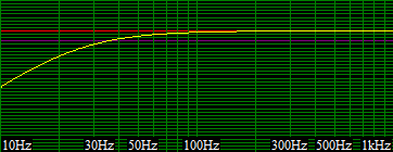

My unheated cottage had plenty of room for the Batspeakers converted to subwoofers but in this cozy (12x15 listening room)townhouse, no way. Actually, I need subwoofers, now that I have neighbors on either side, like I need another......
So I cut about 14" off the top down to 2.8 cubic feet and they remain sealed. They were always only 13" deep so they'll go against a wall w/o taking away too much.The Win ISD plot is even better, somehow, if it can be trusted, with a shallower roll-off and lower F6, 23 Hz. I have a piece of shiny black formica I've also had laying around so the fronts, sides and top will get covered and they'll look decent.
