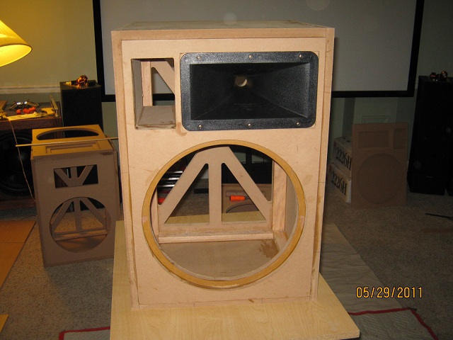

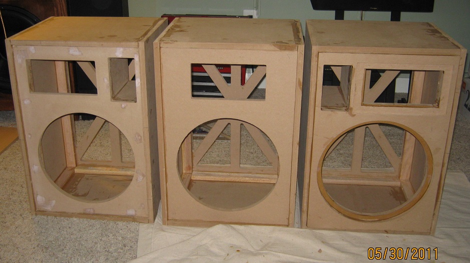

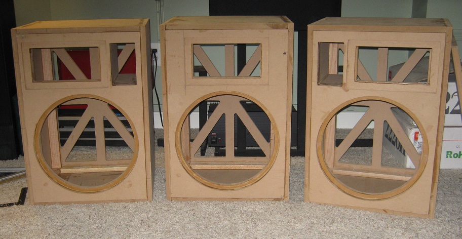

Re: 4 Pi Home Theater Build [message #67966 is a reply to message #67899] Tue, 31 May 2011 18:52 Go to previous messageGo to next message
Messages: 143
Good weekend for the speaker project (although wife complained I spent to much time in the basement Embarassed).

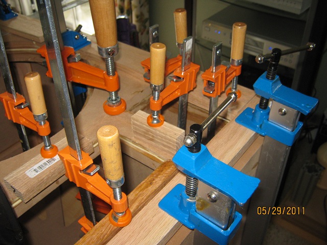

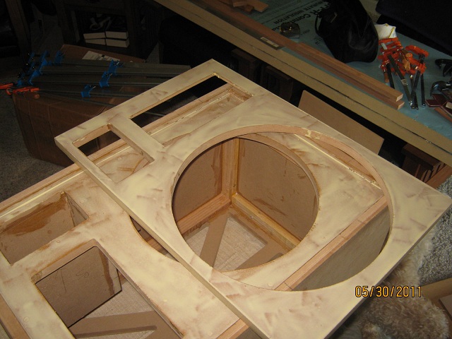

Added the rear and fron inner baffle to the center channel speaker (completed this task last weekend for L and R enclosures). Bondo'd over all the screw holes, sanded and glued on the outer front baffles.
index.php?t=getfile&id=449&private=0
index.php?t=getfile&id=446&private=0
index.php?t=getfile&id=447&private=0
index.php?t=getfile&id=448&private=0
index.php?t=getfile&id=450&private=0
I was very happy that the port lined up perfectly into one continuous unit (3 glue joints - 2 baffles + port).

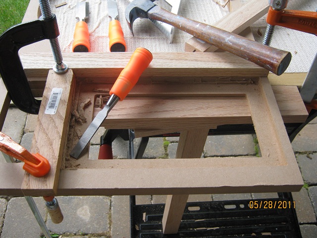

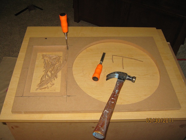

Re: 4 Pi Home Theater Build [message #67967 is a reply to message #67966] Tue, 31 May 2011 19:02 Go to previous messageGo to previous message
Messages: 143
Unfortunately, the pre-cut openings for the horn were incorrect (they were to small). After much internal debate about getting out the router and developing some sort of jig I decided to remove the extra material with a chisel.
index.php?t=getfile&id=451&private=0
index.php?t=getfile&id=453&private=0
index.php?t=getfile&id=452&private=0

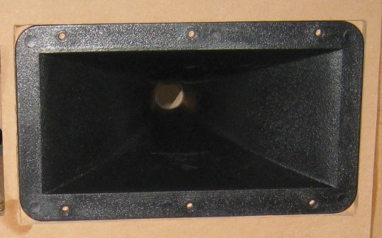

Here is a closeup that shows a little bondo will be required - but it would bave any way as the radius of the horn corners is very different than that of the baffle.
index.php?t=getfile&id=454&private=0
Had to be careful not to split the MDF into layers for the thin section between the horn and the port - actually did on the first speakers but a "flavor injector" from the kitchen filled with wood glue fixed the problem.
