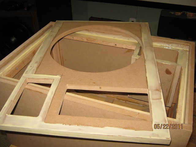

Re: 4 Pi Home Theater Build [message #67780 is a reply to message #67727] Sat, 21 May 2011 22:26 Go to previous messageGo to next message
Messages: 143
Made some progress on the enclosures today.
Internal Frame - designed to increase structural robustness of the MDF as the speakers will be subjected to mutliple military moves.
index.php?t=getfile&id=412&private=0
index.php?t=getfile&id=413&private=0
index.php?t=getfile&id=414&private=0

Re: 4 Pi Home Theater Build [message #67781 is a reply to message #67780] Sat, 21 May 2011 22:30 Go to previous messageGo to next message
Messages: 143

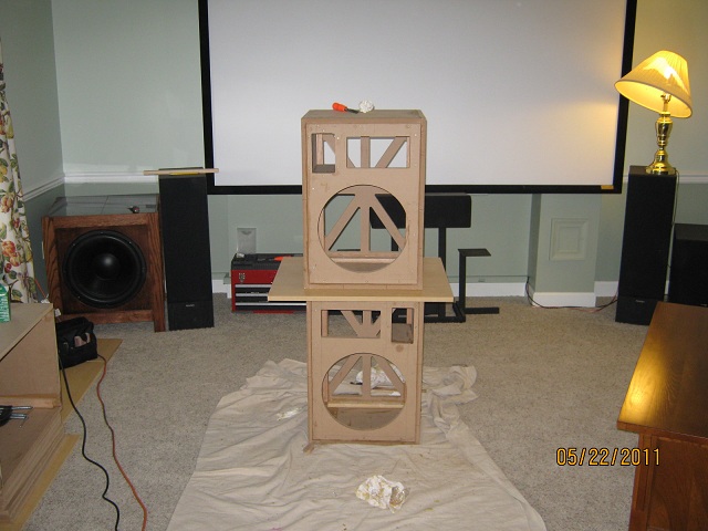

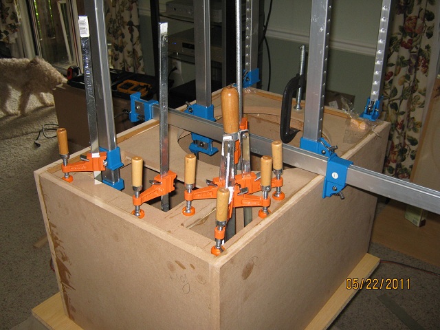

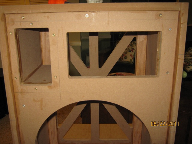

Re: 4 Pi Home Theater Build [message #67804 is a reply to message #67782] Mon, 23 May 2011 11:01 Go to previous messageGo to next message
Messages: 143
Was able to get the inner front baffle glued/screwed before I had to return to Newport for the week (left nice warm Maryland for cold, drizzly Rhode Island Sad ).
index.php?t=getfile&id=425&private=0
- I use a paint brush to apply an even coating of Titebond III glue (2x on the MDF edges as it soaks in during the time required to apply all the glue).
index.php?t=getfile&id=426&private=0
index.php?t=getfile&id=427&private=0
index.php?t=getfile&id=428&private=0
The final picture shows my 18-year old Paradigm 9se MkIII speakers these will replace, my 24" sealed sub (Exodus Audio, Maelstrom-X 18" driver), a bit of my Paradigm PDR 12 sub, and my projection screen. Only the two 4 Pi speakers and the PDR 12 sub will be making the move to Cambodia, the remainder will be going into long-term storage.
