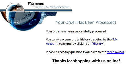

Messages: 143
Just pulled the trigger...it only took 2 years.
index.php?t=getfile&id=410&private=0
I ended up going with the JBL 2226H and B&C DE250 drivers, and the upgraded 15 guage inductor. Decided not to go with the upgraded capacitors and resistors.
