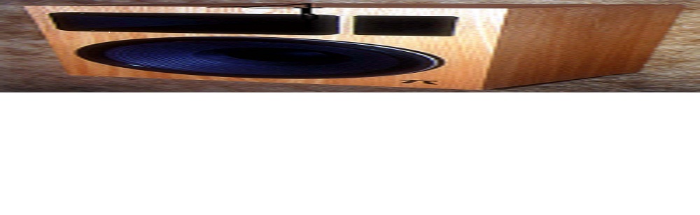

Hi Wayne, I have limited height for speakers. Max height I can accomodate is 24". I can go up to 40" wide and up to 16" deep but can only go 24" high. I am looking at doing the JBL 2226 and B&C 250 components. I could keep similar interior volume at 24" high x 20" wide x 14" deep. Would this affect the Xo design any?
Any benefits going even wider? Thanks!
Re: Any wiggle room on the 4pi dimensions? [message #67555 is a reply to message #67552] Wed, 11 May 2011 15:11 Go to previous messageGo to next message
You mean...Like this?
index.php?t=getfile&id=383&private=0
Re: Any wiggle room on the 4pi dimensions? [message #67557 is a reply to message #67555] Wed, 11 May 2011 16:25 Go to previous messageGo to next message
Bill's right. There's just no room to squish this box any shorter.
Re: Any wiggle room on the 4pi dimensions? [message #67558 is a reply to message #67555] Wed, 11 May 2011 16:55 Go to previous messageGo to next message
GoCaboNow is currently offline  GoCaboNow
Messages: 3
Registered: May 2011
I am a little stuck with my screen wall. I might be able to squeeze out another inch to 25"??
Re: Any wiggle room on the 4pi dimensions? [message #67559 is a reply to message #67558] Wed, 11 May 2011 17:07 Go to previous messageGo to next message
Yeah, you could probably shave that much off the bottom. It's a tight squeeze, no matter how you slice it.
Re: Any wiggle room on the 4pi dimensions? [message #67562 is a reply to message #67559] Wed, 11 May 2011 18:05 Go to previous messageGo to next message
Messages: 3
25" tall and 1/2 wider at each side to make up the internal volume should work?
Re: Any wiggle room on the 4pi dimensions? [message #67566 is a reply to message #67562] Wed, 11 May 2011 19:43 Go to previous message
Yes, that should be fine.
