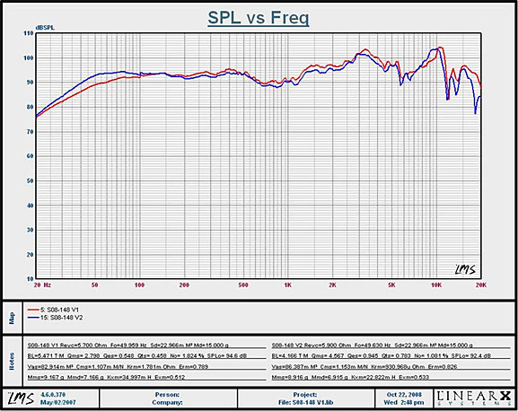

What's your thought on enclosure type, also should I ad the tweeter and what type of x-over, or should I utilize 'full range?'
Prefer 1-2 cubic/ft sealed enclosure. Thanks!!! (blue line on chart)
index.php?t=getfile&id=381&private=0
BETSY -K:
Re 5.7 ohms
Fs 49.959Hz
Sd 22.966
BL 5.471
Qms 2.798
Qes .548
Qts .458
Spl 94.6
Vas 82.914L
Mms 9.167g

I can't make out the notes on your attachment. Could you give a brief description of you two different cabinets?

You have the Betsy-K. (You did actually buy a pair, didn't you?) You have no options. You will have to use a sealed box. It is remotely possible that it will go into a BR, but it will be huge. Again, you might fit it into a BiB.
The graphs you are looking at were most likely made on an OB. The clue is that the higher Q Betsy goes lower in the bass than the lower Q Betsy-K. This is why you would choose a high Q driver for an OB application. Actually, everything you need to know is on that product page.
Bob
