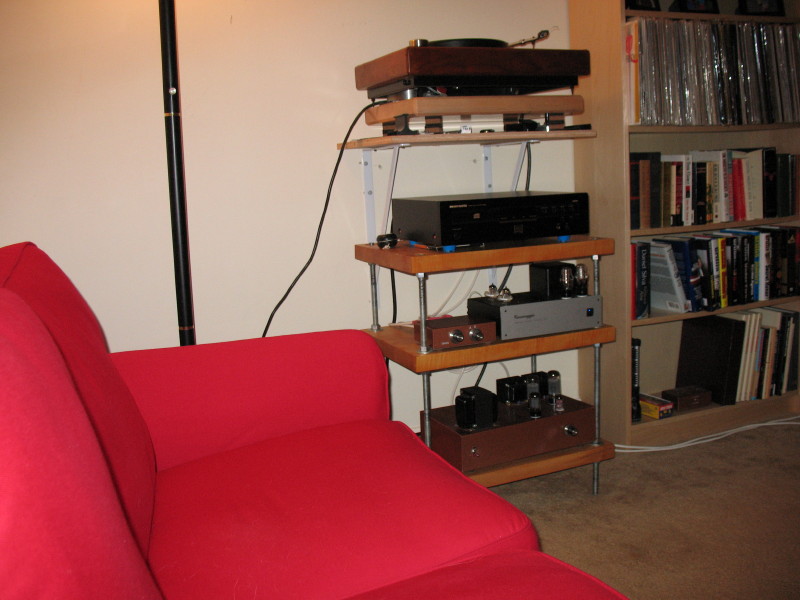

You know, I spend time on the Forums reading about how good or bad this or that is, then I play, as I did today a Chesky re-issue of a Layton/Mohr RCA recording of Scheherazade and just feel like "it" couldn't get any better. HW-19, AT-1005, Soundsmith re-tipped Aurum Beta S, Caravaggio phono, George Andersons SE Pentode circuit and finally, 4 Pis, all connected with "White Lightning" cords.
