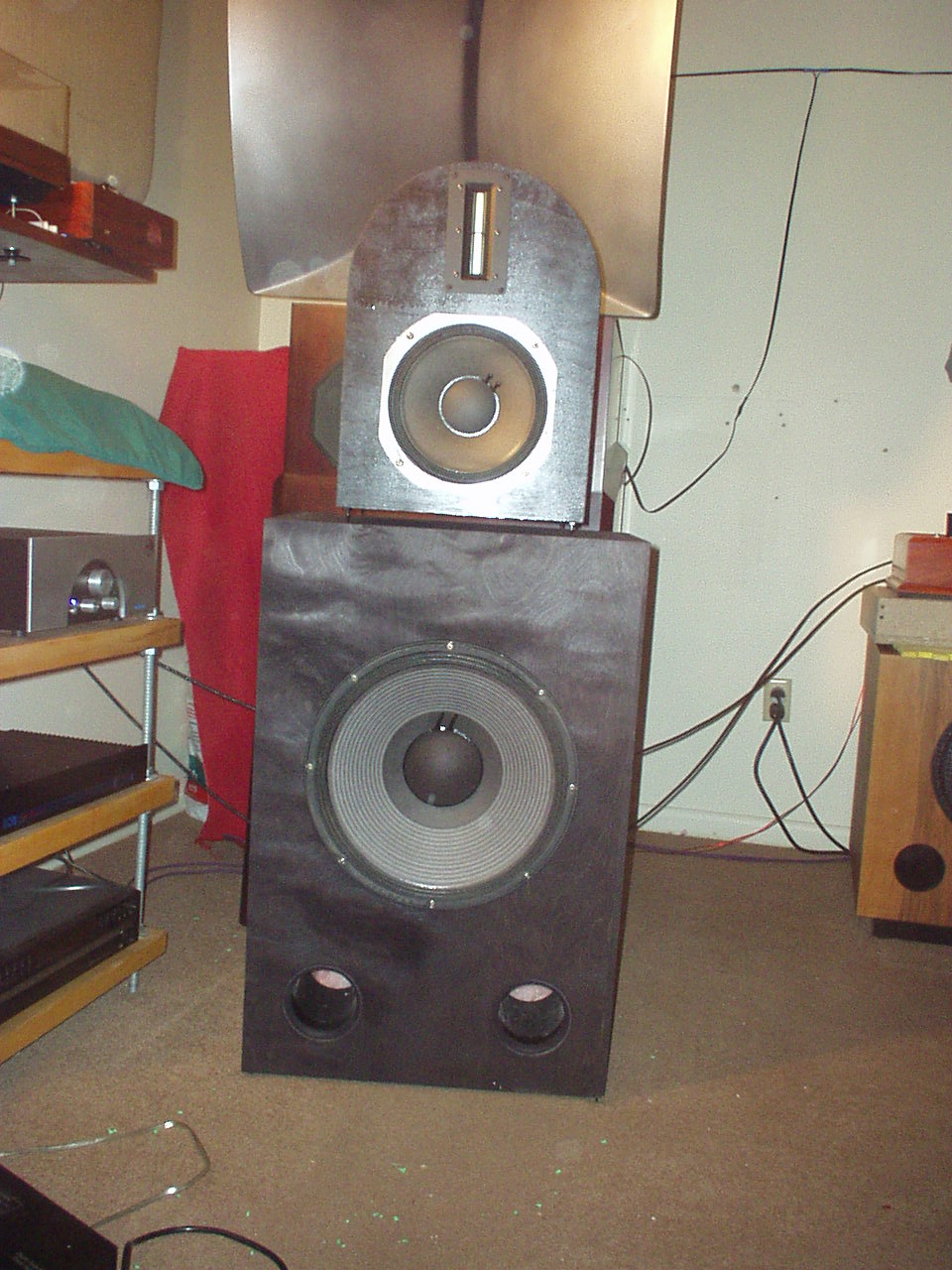

Re: Back EMF? [message #67353 is a reply to message #67296] Sun, 01 May 2011 18:00 Go to previous messageGo to next message
Frihed89 wrote on Fri, 29 April 2011 19:05
Thanks. The guy who warned me is actually a very accomplished speaker designer, but tends not to like 2-way designs for high efficiency.
He'd love this:
index.php?t=getfile&id=379&private=0
... except the 2123s were "blown" and the "high efficiency" ribbons were anything but. Good intentions, high-quality drivers and a lot of plywood a good speaker does not make.
Remember these Bat-Speakers? And the giant horns attached to the XLH 1812s directly behind?
