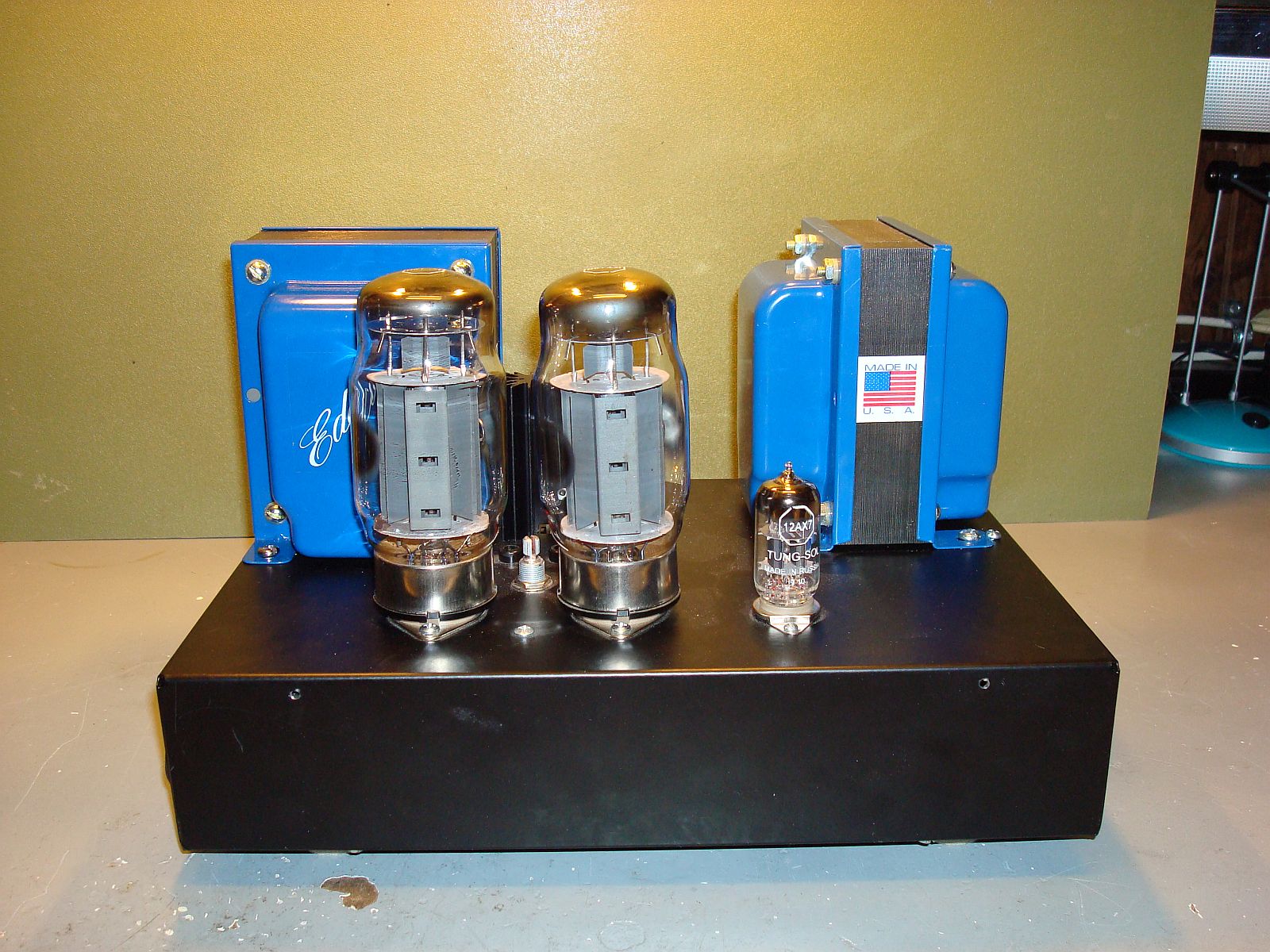

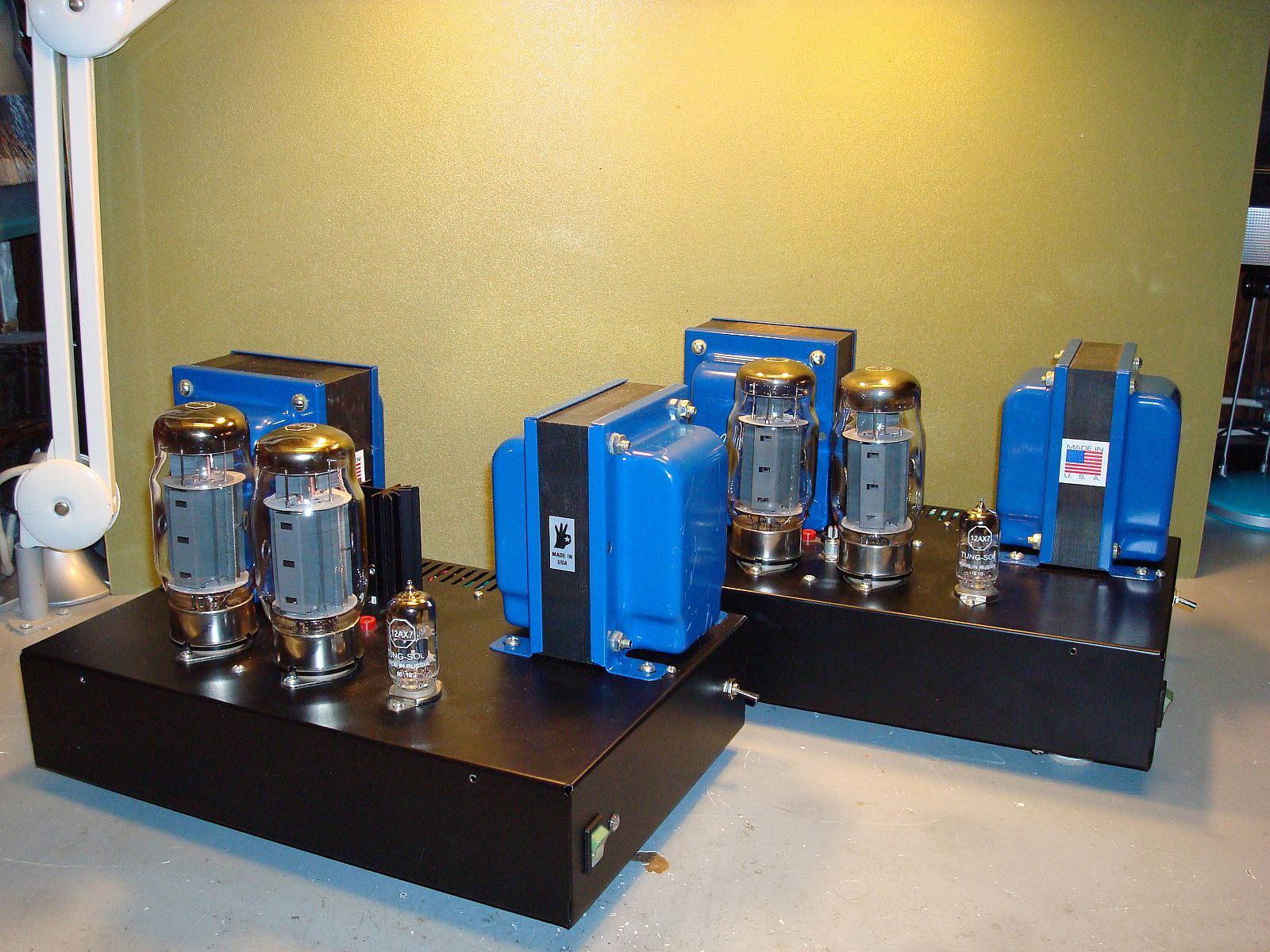

Hi Everyone. The Prototype KT120 mono-blocks are up and running and will be demo'd at the LSAF. Powerful, even with zero time tubes they sound rather good. Look for a diy project on them as well as future kits. These amps are not for the faint of heart nor weak back. In the present configuration (chassis is too small) they weigh in at over 28 pounds each. Power output is approximately 40 watts RMS. Testing to follow as soon as I can.

That is one meaty amplifier. Looks great! Can't wait to hear 'em...
Re: KT120 Class A Push-Pull U/L Mono-Blocks [message #67349 is a reply to message #67334] Sun, 01 May 2011 16:31 Go to previous messageGo to next message
Thanks, They still need a bit of taming, but in the raw form right now can develop 46 wrms into 4 or 8 ohms. Initial spectrum analysis shows more thd over about 1/2 power than I would like, Confused but that is just a detail and can be cleaned up.

Hi Everyone, The KT120 amps were in use for a while at the LSAF. As you might expect, they really put out serious sound. Shocked The design process is on going and a number of refinements underway. These are shaping up as mega power amps (at least for a class A tube design. Power output is coming up to spec in the 40-45 watt RMS range. They are so mighty that one smoked my test load bank. Uh Oh The smell of smoldering plastic was the first clue. Oops. I have some upgraded parts on order and expect the design to be finalized in about 2 months. Kits will follow at a later date (it takes time to source things like circuit boards and chassis). In accordance with the way I design, as soon as the design is finalized I intend to post it under group builds as a diy project for those of you who like to build from scratch. My experience is that there are at least two types of audio enthusiasts, those who build from scratch and those that don't. I like to cater to both.

Hi Everyone, I'm still waiting for bigger power transformers for the amps. I have made some design improvements since the LSAF. Even with the under sized transformers they deliver close to 40 W RMS. These amps should be just the ticket for folks using thing like Maggies that are power hungry. Stay tuned for developments.

Hi, Power hungry listeners. Rolling Eyes I have installed the new transformers and the amp behaves quite well. Unfortunately, I smoked my PC based DSO and can not do accurate measurements on it until I get another one. The stand alone DSO I have just can't keep up with the PC one. I sent the fried one off to the repair shop and they called back and wanted to know what I did to completely smoke the board and make it un-repairable. I suggested that test gear should be protected against 175 volt spikes on the ground. They didn't see the humor in it. Anyhow the KT120 amp sounds quite nice and has lots of muscle. Using my back up test gear I show a power output right on design spec at 45 watts rms. Now all this comes with a lot of heat as the B+ is 440 and idle current is 310ma. Each mono block consumes roughly 190 watts to make 45. About right for a class A U/L amp. More to follow as soon as I can replace the scope.

Hi Everyone, Progress is in the offing.... I got the replacement DSO and now can get back to the KT120 Oddblocks. Smile One is now on my bench. I expect some good news in a week or so. The new transformers are in place and initial measurements show right on 45 wrms in class A U/L mode. Right on target for the design. These amps really demonstrate the thermo in thermionic equipment. Rolling Eyes Folks in the north will love them in the winter. Down here in Arizona, well...... not needed at this time of year.
