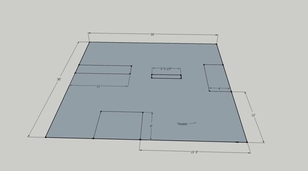

That might work for my theatre as it is a open concept, how does multiple subwoofers work if using horn-loaded subs? The ceiling height is 9 feet above the theatre and 8' everywhere else.

By looking at the drawing of my basement would you recomend a baffle?
Re: 3pi wall baffle [message #67065 is a reply to message #67062] Fri, 15 April 2011 22:14 Go to previous message
Again, flush soffit mounting will prevent a directivity change at low frequency. But in rooms this size, the directivity shift occurs in the modal range, so it doesn't buy you much. Best to run multiple subs, especially since your room is square.
