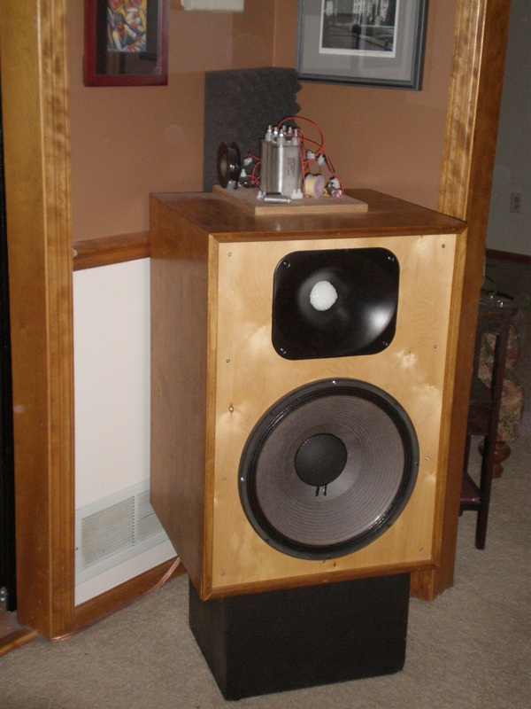

I have one proper corner but the other is the problem. One leg projects approx 30" and then opens into a pass through leading to the kitchen. The other leg projects approx 22" then opens to another (8'-0") pass through into the living room. Not much opportunity to create a false corner here without running the risk of divorce Wink
index.php?t=getfile&id=338&private=0
I do have a couple pair of 5 cu-ft 4507 cabs that I can use for LF. One being loaded with JBL E145's and the other empty but I do have a pair of 2225J's not doing anything presently. A little x-over massaging should take care of that if I go that route I would imagine.
Wayne, I have a pair of Eminence Delta 10A's that I would assume would work well for the mid horns but they are occupied in another speaker at the moment. How particular is the mid horn when using a different driver? I just came into a pair of Audax PR17's (7" mid drivers) and I would be interested in trying them out with the your mid horn kits if it wouldn't frap up the works too much.
