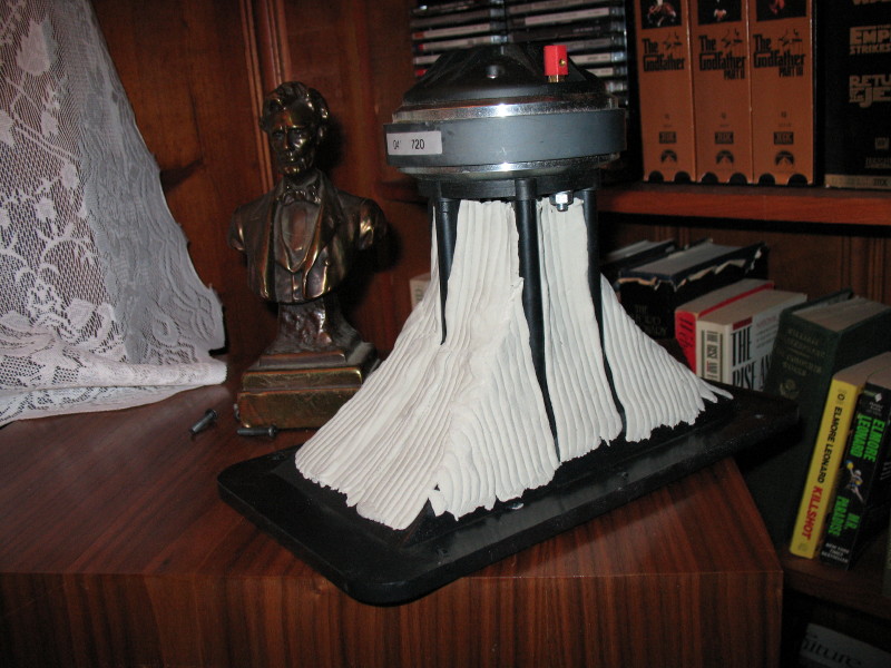

What? You didn't caulk the horns Shocked Shocked Shocked

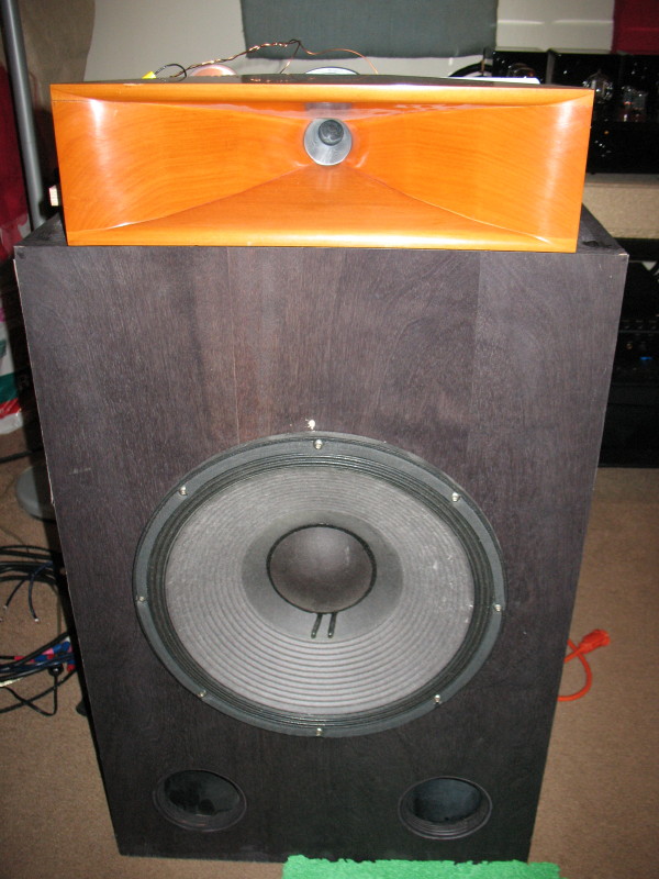

Just so you know my DE-250s were over a year old with at least 1000 hours on them before I mounted them to the H-290s. Prior to the 290s, they played through woodhorns which have a seductively musical but less focused sound than the Eminence.

I immediately loved the H-290s except for a noticeably "plastic" coloration. Maybe not plastic but certainly there was an artificial ringing that came with the extra focus that bothered me. The rope caulk eliminated it and took the 4Pis to a new level.

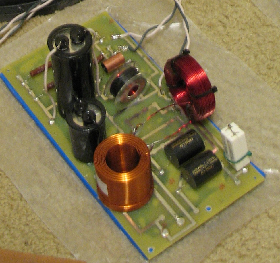

Those who know me are aware I'm not much for tweaks but I am death on vibration control. My crossover is mounted on 1/2" of EAR Isodamp (the blue stuff in the pic) glued to the cabinet bottom with EAR Microsorb (which is why there is wax paper under the board in the pic). The rope caulk is in the same cause and it, like the EAR products, works.

Thanks for posting the pics Bill. The rope-caulking seems easy enough to do. Will try it out soon.
Where did you buy the EAR isodamp blue sheet?

Michael Percy has EAR products. The T Amp won't be here for a few weeks.

What is the rope caulks purpose? To dampen the plastic and stop it from resonating? I know nothing about all this and I'm curious.
Re: Gonna energize my 4Pis [message #66671 is a reply to message #66669] Tue, 15 March 2011 20:48 Go to previous messageGo to next message
justphil wrote on Tue, 15 March 2011 21:28
I don't know what it does. All I know is, in the first few seconds they played when newly built, one of my first thoughts was 'plasticky treble' and would I regret leaving behind the woodhorns.
I once put the caulk on (so-called Cowbell) Altec 811s which had little, if any, effect. But I figured, "what the hell" maybe THEY had the right solution but the wrong horn.
Caulked'm. Right away, plastic sound gone!
