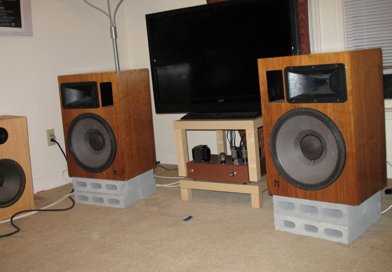

Re: 4 pi, oh my! [message #66262 is a reply to message #66257] Wed, 23 February 2011 02:41 Go to previous messageGo to next message
Messages: 241
Bill,
What makes the bigger difference, the change of woofer or tweeter?
Steve
Re: 4 pi, oh my! [message #66276 is a reply to message #66262] Wed, 23 February 2011 08:45 Go to previous messageGo to previous message
I don't know the Omega woofer, only the Delta from the old Theatre 4, but going to the JBL 2226 has to make the bigger change as it's in the music-range, 150 to 1600 Hz. Also, the 2226 has a mid-range that just kills all those darling little 86dB, 6" drivers in the $10,000 speakers I've heard.
