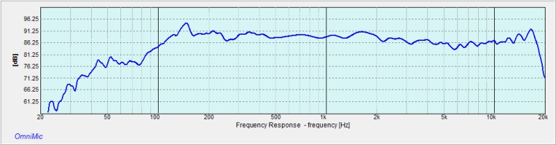

It has been some time since I posted any information in this thread but this week I have been playing with a new measurement system I purchased to test my speakers, some planned sub-woofers, room set-up, and the overall acoustical design of my space. I picked up the OmniMic from Parts Express.
My thoughts relative to the Pi's are to do some of my own measurements of the effect of the SMX screen in the audio path and the impact of adding some foam to the waveguide.
To start this is my first pass at measuring one of the 4Pi's in place in the wall with the microphone about 3 ft away. This is with the screen in place:
http://www.PiSpeakers.com/DIY/BigmouthinDC/BigmouthinDC_4Pi_HomeTheater_31_InRoomMeasurement.jpg
I hope Wayne doesn't mind but I'm copying in one of his published graphs:
http://www.pispeakers.com/Measurements/fourPi_response.gif
I'm actually pretty happy that what I built looks to me about what the Master designed. I wonder about that sawtooth uptick in the higher frequencies that I can no longer hear. Maybe some screen interference issues.
When I finish building some new sub-woofers I'll be taking down the screen and at that point I can measure without the screen fabric.
icon14.gif  Re: Three 4Pi's in Basic Black for Home Theater Build Thread [message #65989 is a reply to message #65984] Sat, 05 February 2011 10:04 Go to previous messageGo to next message
Messages: 19102
Thanks for reporting back. It's always nice to get feedback from people, especially when they've done as much work as you have.
I'm impressed to see this measurement through the screen. It's pretty much the same chart as you get from an anechoic measurement. There is usually more ripple than that when you add a grille or screen.
Your system looks great! All you lack is getting the subs added in.
Great job!
