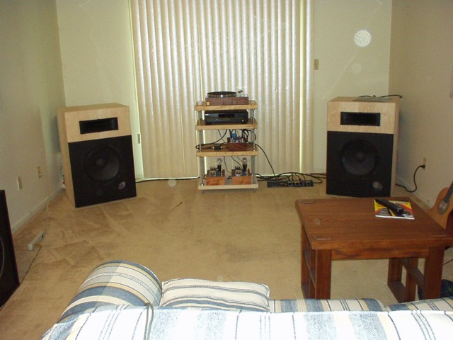

Thanks, Wayne. I think I'll build them like I did my very first Delta 4Pis. You remember, with the double baffle for the woofer painted black? I'll have to go a lot more than 3/4", tho'.
Wow! That's 10 years ago!

Those were some of the best looking speakers, I loved them! And I always liked those Peavey horns too. They were my favorites in the 1990s.
