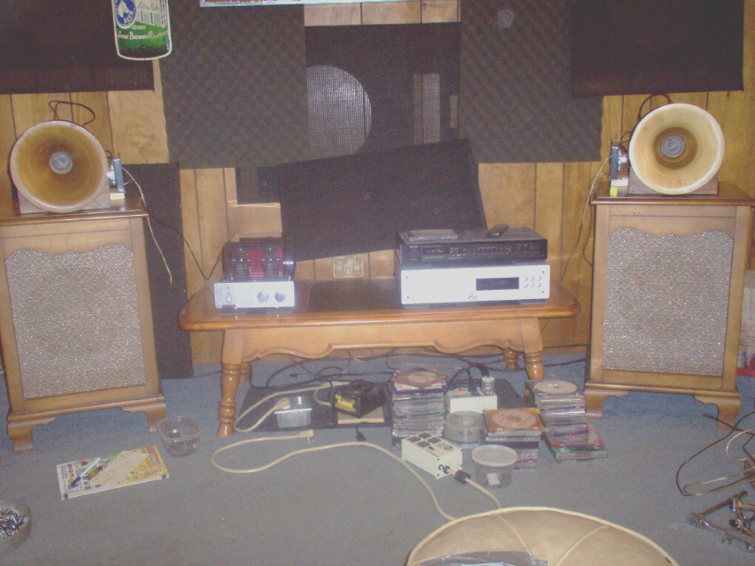

Right now I'm running EV SP-12's in 2.5 cu ft ported cabs with 500hz Edgars on top. I used the 3 pi crossover as a start and modified it with a "split" frequency (10 ohm LF @ 1100 hz - 8 ohm HF @ 1900hz set for 14db att/EQ. I'm running Be diaphrams in JBL 2446 LARGE format driver. The system runs out of steam below 60hz, but does not sound like it!
Ron sends....index.php?t=getfile&id=298&private=0
  • Attachment: latest 2.JPG
    (Size: 287.02KB, Downloaded 8108 times)

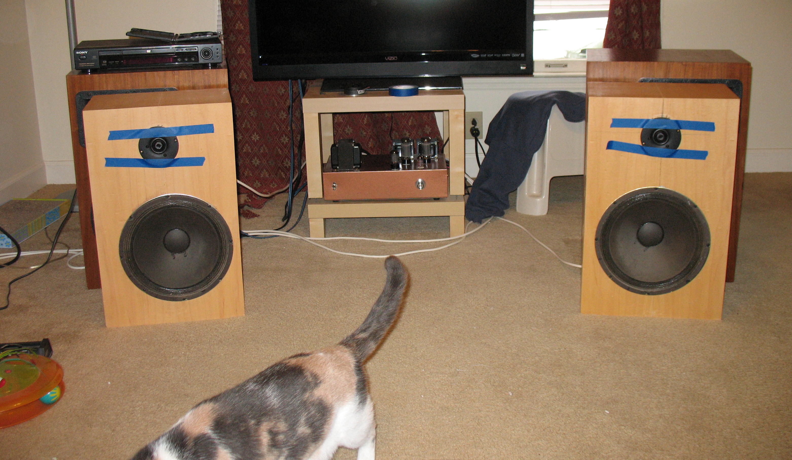

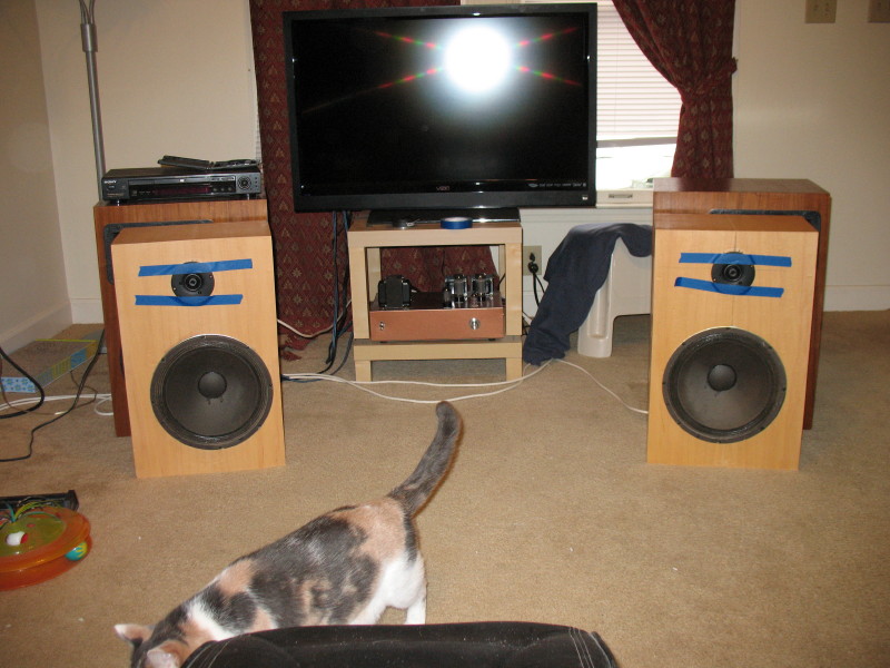

In addition to everything technical I learned from The Spkrman I also got his listening room decorating advice:
index.php?t=getfile&id=300&private=0
not so much that I needed to be able to return the tweets if they didn't perform but, rather that, the BLUE TAPE has that certain je ne sais quoi so often attempted but so rarely realised.
