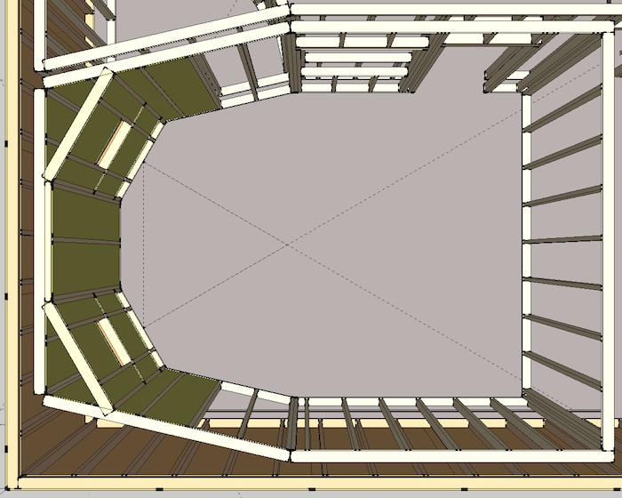

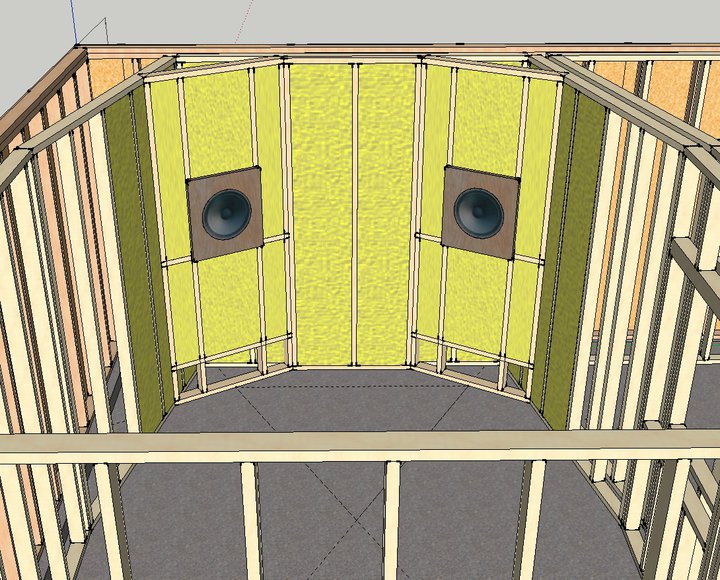

Hello everyone,
The guys over at Hawthorne Audio sent me here with nothing but great things to say so hopefully some of this will make sense.
I am in the process of designing my new studio control room and will be going with a Soffit (flush) mounted approach for my (mid-field) Full Range reference speakers. I have read tons of info about how to do this right and the guys at John Sayers Studio Design Forum have been great helping me out, but I was leaning more towards a custom Passive Full Range Monitor approach as opposed to the standard Brand Name Active Refernece Monitor (Adam, Genelec, Focus etc..) for a few different reasons...
Specifically, my room considerations in regards to size of drivers/enclosure, accuracy of frequency reproduction of components, heat/venting issues for enclosed power amps SIMPLICITY of speaker design (in terms of electronics)for purity of sound etc...
So I guess my questions for you are:
Do you offer your speakers as components? (drivers & x-overs)
Which combo would you recommend for my Control Room?(See attached Pics but disregard the drivers in the 2nd one they are a coax design hence no visible tweeter/horn)
Would your components work without your enclosure (using the soffit effectively as the enclosure) and have you had anybody use this approach with your speakers before? For this type of application? With good/bad results?
I would greatly appreciate any thoughts you have on this and will provide much more info upon request, as my needs are critical listening in the mixing/mastering stage of recording music my attention to detail is exhaustive and my control room design will be acoustically balanced in every aspect possible (given it's limitations of being an enclosed space), thus the marriage between the speaker and the room will be done in such a way as to essentially remove the room from the equation allowing the speaker to reproduce it's content faithfully and provide me with the most accurate respresentation of my source material possible Very Happy

So, I guess my nest question is, would you recommend just using your completed speakers and mounting them into my soffits (as in the University setup), or would there be any advantages/disadvantages to building the components into the front wall of the soffit (resulting in an infinite baffle scenario)?? What are your thoughts on that? The research I have done, shows that in soffit mounting an enclosed speaker you get a 6db boost in lows which needs to be addressed with bass trapping, so my thought is, would there be a plus to minimizing that extra loading by removing the enclosure... Hope that makes sense!
Thanks!
Re: Soffit (Flush Mount) Reference Speakers [message #65293 is a reply to message #65292] Wed, 15 December 2010 19:19 Go to previous messageGo to next message
I would suggest simply building the speakers as designed and mounting them in the wall. If you can close the gap so the wall is the baffle, that's great but as long as the gap is small it is acoustically invisible.
Radiating into half-space does increase sound compared to freespace. The so-called baffle-step compensation is done to conjugate the transition from the region where the baffle is acoustically large to where it is acoustically small.
At low frequencies, the baffle is acoustically small so sound radiates omnidirectionally. At high frequencies, where the baffle is acoustically large (i.e. large compared to wavelength), the front of the speaker causes the sound to radiate into halfspace. (Unless of course the driver's directivity is already making a tighter beamwidth anyway)
So what you have here is changing directivity, and this causes on-axis response changes. It does not modify the power response though. Power response is the total energy radiated in all directions. On-axis is the response straight forward. So if a speaker has constant directivity, they're equal. If not, then the on-axis response changes as beamwidth changes.
π Speakers generate uniform directivity so baffle step is non-sequiter. They're designed to be used with their backs against the wall already. But to tell the truth, there are still some transitions between where the baffle is acoustically small to large, and then again where the room has influence, and wall mounting will help this. So there is a benefit in soffit mounting like that.
