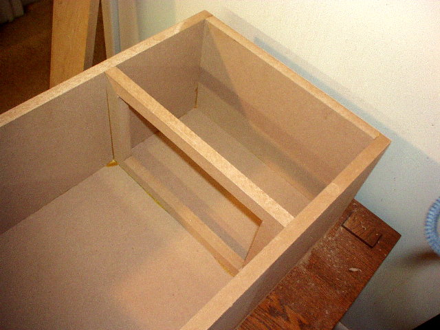

Re: A question of wood thickness [message #65222 is a reply to message #65203] Thu, 09 December 2010 22:02 Go to previous messageGo to next message
index.php?t=getfile&id=286&private=0
Cut these "window panes" with the same saw seting, at the same time, as the top and bottom pieces. They help square the cabinet during glue-up and then function as braces.
