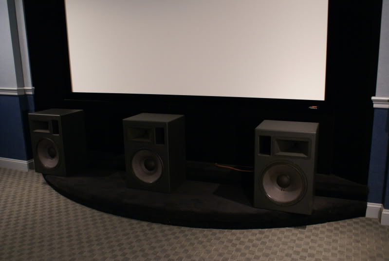

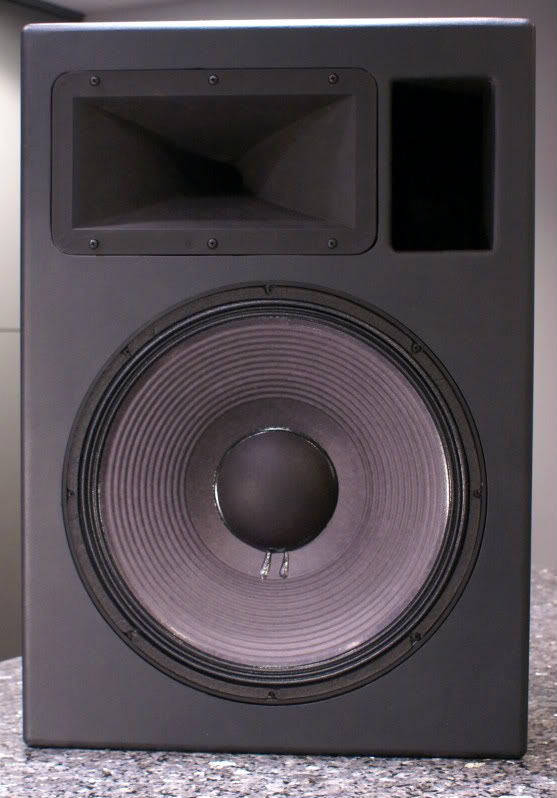

Just carried them in from the workshop, still some dust I see in the picture. All three work. Now to fish out the other wires, and give a run.
http://www.PiSpeakers.com/DIY/BigmouthinDC/BigmouthinDC_4Pi_HomeTheater_20_FinishedSpeakers.jpg

First report. I turned on some Satellite Smooth Jazz and set my Receiver to stereo. When sitting in the masters chair, 3 times I had to get up and put my ear to the center channel because that was were most of the sound was located but of course it was turned off. These things would be phenomenal for anyone needing to run a phantom center channel.

A close up (Speaker Porn)
http://www.PiSpeakers.com/DIY/BigmouthinDC/BigmouthinDC_4Pi_HomeTheater_21_CloseUp.jpg

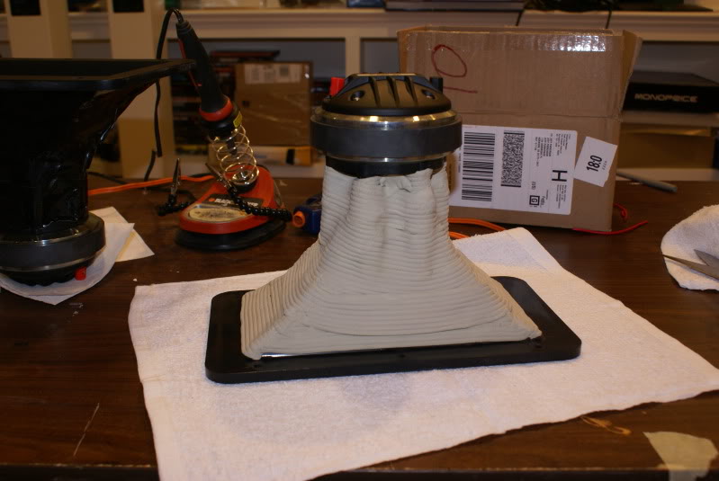

A few more under the hood shots of the construction process.
It seemed like dampening the horn would be a good idea or at least couldn't hurt.
So first a little log cabin style:
http://www.PiSpeakers.com/DIY/BigmouthinDC/BigmouthinDC_4Pi_HomeTheater_22_HornDamping.jpg

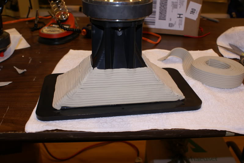

Then a barbershop up and down with the remainder of the roll:
http://www.PiSpeakers.com/DIY/BigmouthinDC/BigmouthinDC_4Pi_HomeTheater_23_HornDamping.jpg

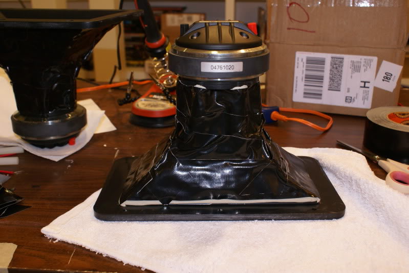

Then I got to thinking about what happens in ten years when the caulk dries so I gave it a gorilla brand duct tape safety net:
http://www.PiSpeakers.com/DIY/BigmouthinDC/BigmouthinDC_4Pi_HomeTheater_24_HornDamping.jpg

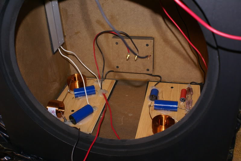

screwed the crossovers in on a 1/8 inch rubber pad.
http://www.PiSpeakers.com/DIY/BigmouthinDC/BigmouthinDC_4Pi_HomeTheater_25_CrossoversInstalled.jpg

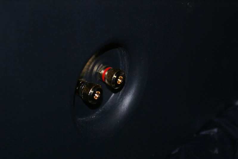

Added some gold plated bling banana plug binding posts.
http://www.PiSpeakers.com/DIY/BigmouthinDC/BigmouthinDC_4Pi_HomeTheater_26_BindingPosts.jpg

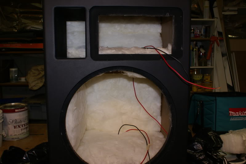

Then the recommended insulation on the bottom, back, a cross section at the brace and the side by the port
http://www.PiSpeakers.com/DIY/BigmouthinDC/BigmouthinDC_4Pi_HomeTheater_27_Insulation.jpg

BigmouthinDC wrote on Sun, 29 August 2010 19:20
I don't damp mine with the caulk, although I have tried it. Bill Epstein, a good friend of mine, recommended it at one time but I personally could not hear or measure any difference. These H290's have a thick body and are dead to the tap. I will say I found it to be helpful on other horns with thinner bodies. I've even had some horns that rang like a bell, at a frequency in the passband. Yikes! But the H290 just isn't like that.
Very good, nice touch. I think it is potentially important to put gaskets under the crossovers, to prevent them from buzzing. I mean, I've tried lots of mounting configurations from mounting on standoffs to wired in line (hanging) to mounting directly to the panel inside. I like this last approach best, because it is sturdy and rigid. The gasket makes sure the board doesn't buzz. I use silicon to tack down the components on the board as well.
Excellent. I noticed you didn't forget the cross-section piece, which is very important to ensure smooth midrange.
