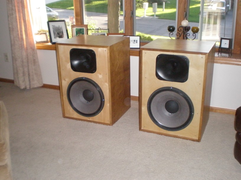

I thought that it was time to thank you, Wayne. After sitting on a pair of 2226H for a couple of years, I went ahead (with over the phone assistance from spkrman57) and completed my own "4 Pi" build.
I additionally used a pair of 18sound XT 1086 horns, B&C DE 25's and your crossover design with about 15dB of attenuation when it was all said and done. After horsing around with the HF circuit some, I settled on that and am very pleased with the results.
Just wanted you to know how much I appreciate your gracious sharing of your work and willingness to help others, including myself.
These turned out really quite good Smile

Glad you're enjoying your speakers! Thanks for posting.
Post pics if you can!

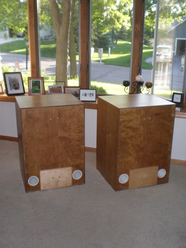

Long story but these cabs originally housed a Altec 15" woofer and 811 horns. After a "bit" of modification, they now have a 3 cu-ft sub enclosure for the 2226's and are tuned to 38. The rear porting was not the plan originally, but came about because of lack of room to allow for it on the front. I guess you would have to view the interior framing to see what I'm getting at. They are about 5 cu-ft internal volume overall. The pics of the crossovers I built for them were taken prior to final changes.

Nice job! They look great in those cabs.

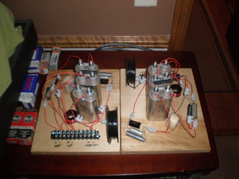

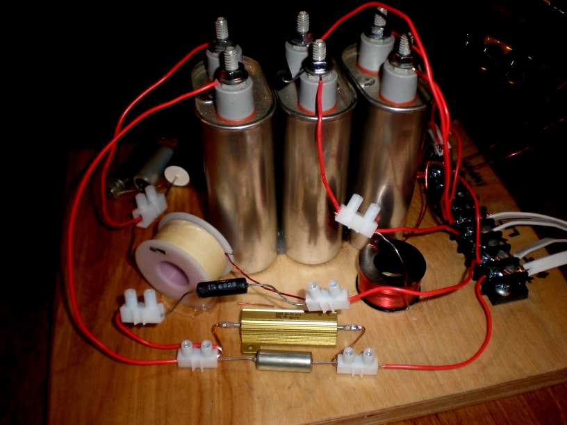

For what it's worth, here is what I have settled on for the x-overs. I followed the "new" 4Pi crossover schematic but with the following changes in the HF:
Because of my low power (SET) requirements, I omitted the multiple series and parallel resistors in the attenuation circuit and used
R1 - 30 Ohm
R2 - 10 Ohm
C1 - .33 uF
I played around with the resistor in the R2 position trying 8, 10,12 and 16 Ohm and finally settled on the 10 Ohm and am very pleased with what I'm hearing overall.
Please keep in mind that I'm just a hobbyist going by ear with no data to back up what my ears are telling me in the HF anyway Very Happy I'm more than open to suggestions so if you have any, let em rip.
Here is a pic of that section of the circuit.
RC

For SET amps, you can reduce the number of resistors just like that. There is no harm having them, but as long as the power stays low, no heat is generated, and no damage to the resistors even if you only use one per R1/R2 leg.
I find time and time again that changing the low-pass (woofer) circuit to set the position of the forward lobe and nulls gives the best results. I would have expected that manipulating the high-pass (tweeter) circuit would be needed, but in practice, I don't find that is the case. I always move both around when evaluating and testing, but in every case, I've settled on the same tweeter circuit. Then again, my designs are all very similar, so the requirements of the tweeter circuit are similar too.
